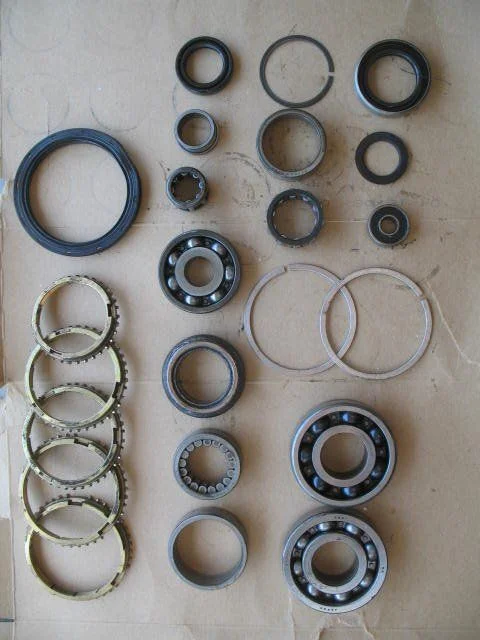

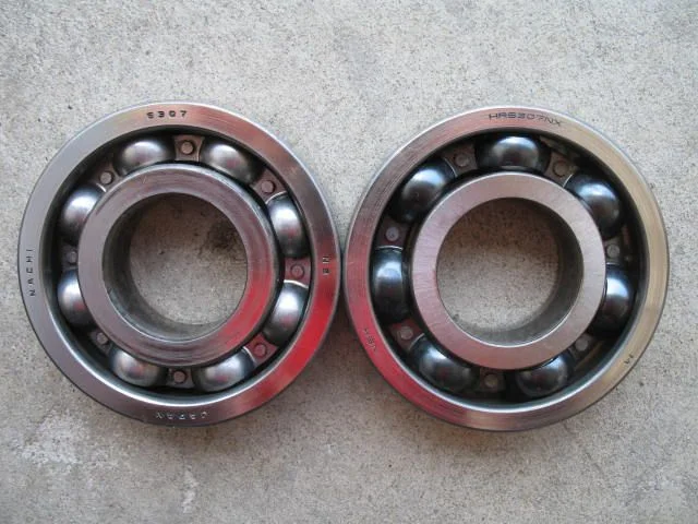

I have a 1988 pickup 2wd that I have owned for 19 years. 155,000 miles. It has a W55 tansmission. Don't know if this means anything in the contex of your 4 wheel drive. I think you have a W56 which is very much like my W55 except for the 1st and 2nd gear ratios.
In the past few years the transmission made noise under acceleration in all gears, except 4th. No noise if I lifted off the gas. Loudest in 5th. Clutch in or out had nothing to do with the noise.
Had a local shop take the transmission apart. The mainshaft bearing was bad. Did not hear the noise in 4th because that is direct drive. Louder in 5th because there is more load on the mainshaft in 5th. Input shaft was also starting to go bad.
A rebuild kit was put in that includes all new Japanese bearings. This is a picture of the old parts. The input and mainshaft bearings are the large ones. In my transmission both bearings looked the same to me. The mainshaft bearing was hard to spin smoothly. When I spun the input shaft bearing it was like there was some sand in there - but not as bad as the mainshaft bearing.
Lucky the rebuild was $300 for labor and $220 for the rebuild kit. Guy who owns the shop rebuilds transmissions, rear ends, transfer cases, and anything else that moves on a Toyota. Also restores Landcruisers. He was a lucky find.
Drives like it did when I bought it 19 years ago.
