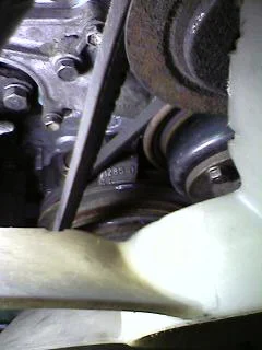

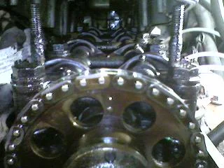

Ok, IH8 to ask such dumb questions but like I've said I've never lined the marks up EXACTLY in any 22R/E
So...
The cam TDC appears to be 7deg before crank TDC. Shouldn't I be able to pull the dist and match the dot to the cast line, slip it in and it'll be right. Right?
Once again, when the crank is at TDC and the cam is always 5-8 degrees off.
The dist goes to the cam. So, if the cam is off 7deg, then if the dist is dead on #1 then that should be it, right?

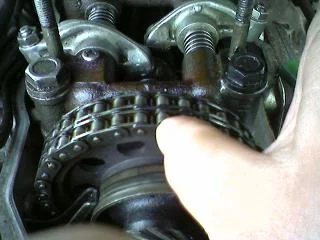

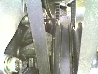

here's as close as I've gotten w/ my 20/22R
My thumbnail is at the "dot" and the crank is at 0deg TDC.

could this be a problem?
1st off the pic is wore than it looked from the view finder...but that's what I get for buying the cheapest phone.
2nd, there are two match marks, one is a paint on and one is a mark on the rim of the dist. I've never seen the mark on the rim so I don't know if it's a Toyota thing or something someone put there but it looks factory, very well made.
The paint means someones been in it. NOTICE: I tried to match the button with the mark and the signal rotor.
NOTICE it is way off...

these pics are of the one that came on it. It was a donor so I had little time with it before the motor came out. Looking (Waaaayyyyyy) back, it seems the dist was turned as far one way (???) as it would go, and that's the only way I can get it to run.

this is a pic of another dist, I have no idea what it came off. I'm hoping the dist's for RTEs are not specific...but I would think so...

you can use any distributor off all the 20/22R/E's as long as the plug fits together.
dont use the marks inside the body of the dist. line it up with the center of the bracket that holds the plug.
Are you sure you are putting it in there when its TDC at the compression stroke, not the exhaust stroke, and while the crank pulley mark is at either 5 or zero?
