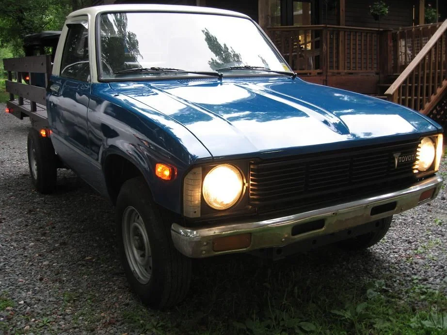

rust is not bad. There is power to one of the cables that goes to the horn. I guess it may be a the cable that goes to the steering wheel, since i dont have nay power there.
Here is a pic of the truck
