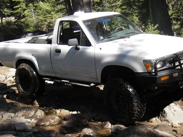

I love this pic, so I'll shamelessly show it again.
The James Caird getting things done at last years 45 Run.

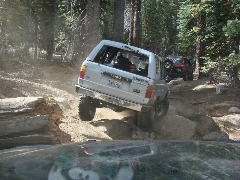

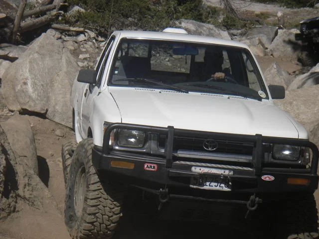

Here is the recipe i used. My 93 has factory 4.88's, rear locker, a 1" body lift, cranked stock t bars, low profile bump stops, sway bar disconnects, 2" downey rear springs, trimmed rocker panel/smashed down firewall seam and trimmed the rear of the front fender and front of the rear fender. This allows it to clear 33 by 12.5 tires on 8" rims with 3.75 backspacing with no rubbing. Now if you care about asthetics, I actually took care to bend the lip of the trimmed front fender back and extend the plastic liner with some black sheet plastic from tap plastic. A piece of plastic from a tacoma bumper nicely filled the gap between the body and the arb bumper. The plastic piece that covers the trimmed section of the rear fender can be molded in place with a heat gun to cover the trim job and fill the holes that would result if it were permanently removed. This setup has got me through the rubicon. Oh yeah, forget about the mudflaps. If you wheel it, I also recommend an idler arm brace, I also added a "rear control arm bracket brace/spreader. this is the most i will build the ifs. If i feel the need for larger tires then I will sas it.

Again, great ideas and recomendations I need to know about. He is already set his sights on an ARB and rear locker and his is white also. Great pictures to aim for with the stance. A simple 1" body lift will add to things with the Downey rear springs I'm looking at.
