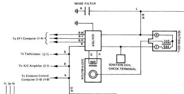

Have you hooked up the wires to work the starter and turn it over?
Here's the ignition diagram from an 85, I can't imagine yours is any different.... Disregard the EFI wires noted.....
