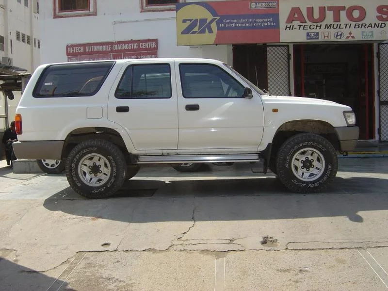

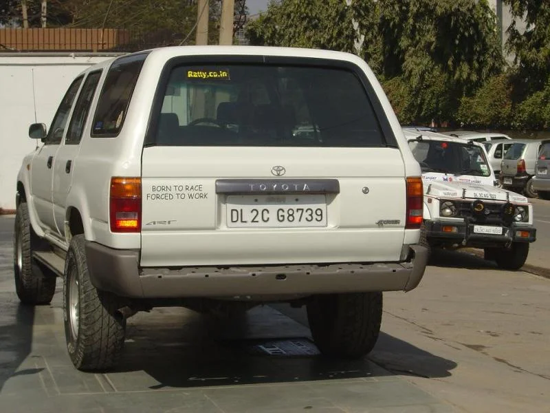

will post pictures of my 4runner very soon

Nice looking truck!
