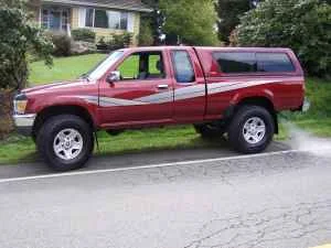

Anyone done a Head Gasket replacement on a SR5 ?
I found one with a LITTLE bit of damage for $400 that needs a head. Thinking about picking it up.

That for only 400 bucks. What else is wrong with it? That looks like a real good deal if all it needs is a head gasket. Drop in a brand new engine for a couple thousand and still come out way ahead.

Yea, this side looks good. Other sides been hit in the lower rocker... though the door does still shut.
I think it has a 22re engine in it. I'm wondering if they are hard to replace.

I like how it's blowing steam in the pic..... That's great!
Seems like a good deal to me. 22RE is pretty easy to work on. If you just want to change the headgasket, it's a 1-2 day project depending on any trouble you run into...
