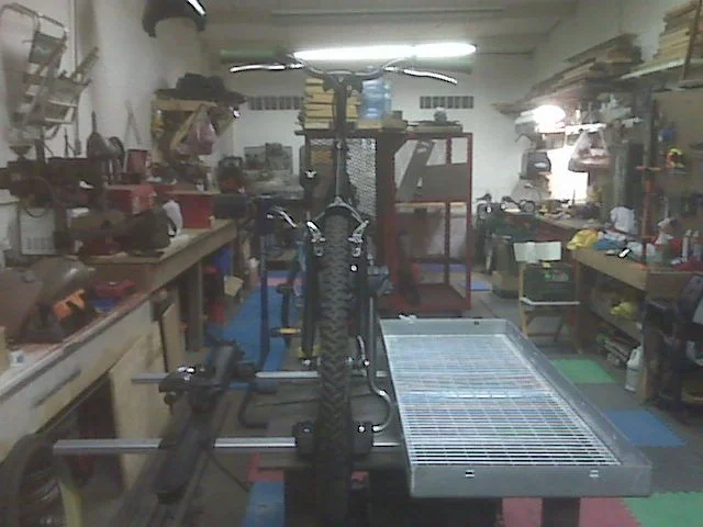

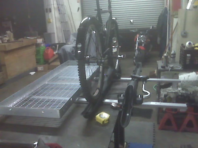

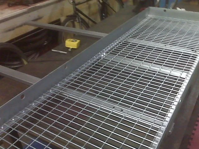

As usual, no time, little money, What I did was - buy a Hitch Witch, 20"x60" and this is how I'm gonna mount it:
BTW, hitch witch: $144 shipped, made in USA, everything described one web site is true, it is very stout, and well put together. Got to my door in 2 or three days from ebay. no connection.
The mock up:

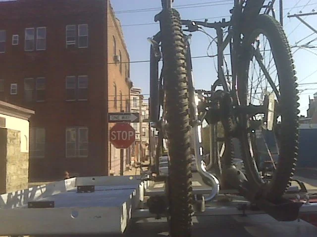

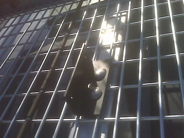

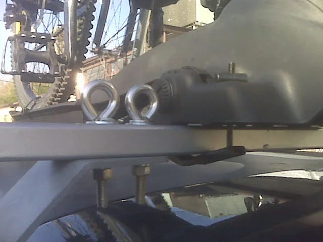

Mounted it all for a test run today. I had these brackets laying around the shop so no fabrication was required, and I used the holes that are there to mount the cross bar, so no more drilling was required. They also act as another point to bungee x4.I might add two more brackets like the ones there, but I feel like it is fine as it is. Only the boats (17 lbs each) a gas can and a little misc... will go up there.
I 100% recommend Hitch Witch. One nice part of the Hitch Witch- when it is mounted on the roof- one side of the center brace/mount for the hitch, rests in the center of the roof, distributing the weight a little more. I put the confer gutter mounts, as close to the support columns as possible in front and back.
