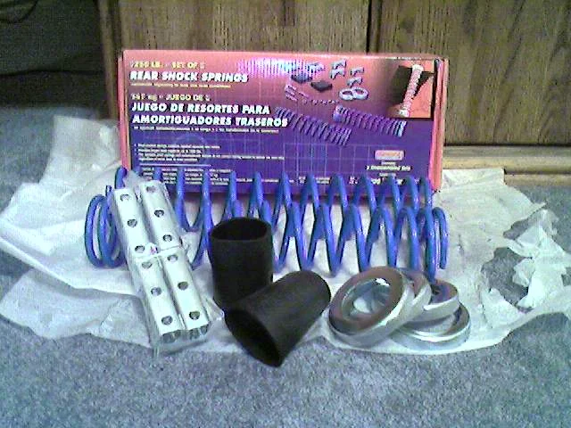

well I didnt want to let the cat outa dabag but $22.95!....NOT EXPECTING IT TO WORK but hey
...gonna try for the front
