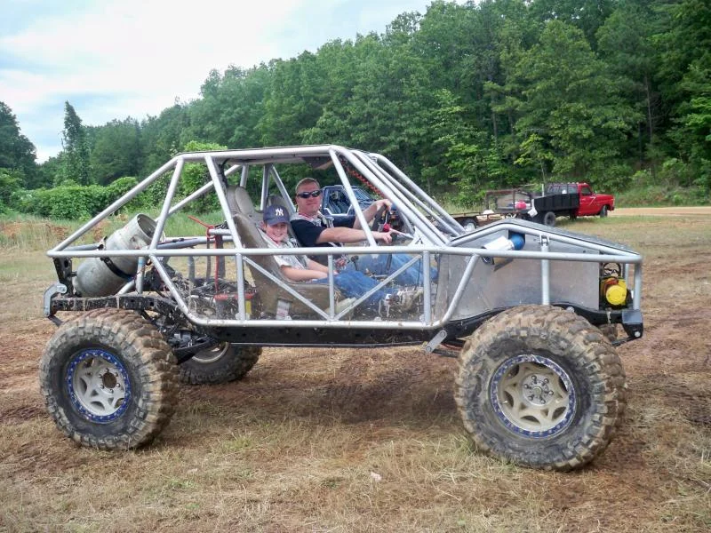

Great rig man, i just attended the SE4RJ last month It was a blast. There was a sweet f-toy there

Thanks, that F-toy is nice looking. once the body gets beat too much I will go F-toy with it.
