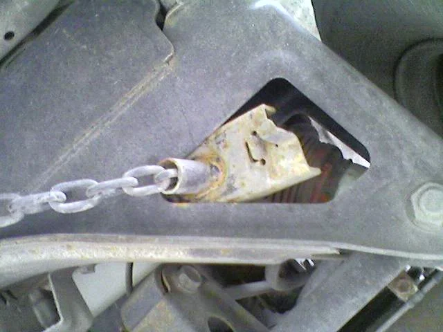

OK, 1st do not look at my pic and think things dont look right, they dont.
I was lazy and put it where it is and cranked up the slack, to avoid rolling it up a mile.
If you do not have a piece that looks like that then your out of business.
If you do, then pass it through the center of the spare and put the two little nips in the holes and roller up

If you've got rust, you might be missing a big piece at the end of the chain, the piece that tntoyota is showing in that picture.
I jumped a railroad track one day (yeah, for fun, and you can get a little air if you're going fast enough), and heard a big thud. Thought it was my toolbox in the back, but later that week, I noticed my entire spare wheel and tire was gone. And somebody had already scavenged it off the track.
You can get a new lifter, chain, and bracket from Toyota. Or you can use this opportunity to get a cool tube bumper with tire carrier.
