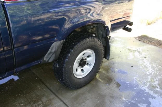

I have a 2.5" exhaust with a single muffler (Magnaflow IIRC--the one with the better warranty ). It is quieter than the 22R-E was. In fact, right after I got it done I drove it about 500 miles without any muffler (just the OEM dump from the turbo and exiting right where the muffler should be). The turbo whine was SOOOO cool there. The only reason I put on a muffler was that at a certain speed, going up hill, I got a wierd resonance that was pretty loud. It is smooth too (I was worried about that because I used the solid mass flywheel). It's at least as smooth as it was with the gas engine, maybe smoother.

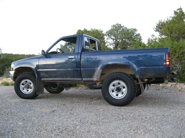

Here's an update for ya!
I've been pining over my bald tires for a while. At 100K+ miles, they were getting kind of threadbare. But, as picky as I am, you know I couldn't just buy new tires (also, that would be easy, and I don't do easy). Nope, I had to take the original wheels (and I actually bought a fifth matching wheel for the spare), get them powdercoated as close to the original silver/gray as possible, and THEN buy new tires.
It's a good thing I have been out of town for the past couple weeks in training, as I knew it would take a while, but my powdercoaters (these wheels don't fit in my oven) had some delays, so the faux-lux ended up sitting on blocks in the shop (in the way of Dad's Power Wagon ) for nearly three weeks waiting to get the wheels back. Well, yesterday on my way back to the airport I finally got my wheels picked up, and got some new BFG A/T 31x10.50R15s put on. If BFG made a 32x10.00 I would have rather used that, but oh well, these have done great for me for the previous 100+ thousand miles, so I'm pretty happy.
Anyway, even though I'm stuck in St. Louis, my Dad must have wanted to get his Red Power Wagon out, so he put the wheels/tires back on the faux-lux for me.
It looks good enough I should probably wash the truck now, just so the rest of it looks as clean and stock as the tires. (no, I won't shine the tires, because that is lame to the m4x0RBz!)
Dan

Now that I'm home: better pictures. Also, I'm busy washing it right now just so it matches the new (old) wheels and their as-close-as-possible original color.
Name:  new tires 1.jpg
And an overall picture.... they look fantastic IMHO.
Name:  new tires 2.jpg
