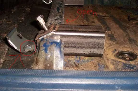

Ok here's an idea.... I measured! My stock mounting holes in my truck 89 4Runner (Not on the 4Runner seats Which were from a 90, maybe by 94 they had changed them....) is 17 1/4 center to center. What do you have in your 90?

I just measured the mounting brackets on the seat versus the mount holes on the truck.
The 4Runner Seat brackets measure 16.75 inches. The stock mounting holes are 15.5 inches. I measured the center of the hole where the bolt would be and measured accordingly. If I started from the start of the bracket to the end of the bracket, then I would get the same measurement.

Ah Ha! So I had to stretch the 90 4Runner seat mounts by 1/2 inch (not a big deal by redrilling), but you need to squeeze it by 1 1/4 inches.... I think you will have to pull the carpet around the front mounts and drill some holes and put a bolt in from the front and a nut on the back side where it's "open" (labeled in the picture).
In this picture you can see the stock nut (circled) that's welded to the back side of the mount, because he cut it open and folded it forward. You can see if using the left or right stock hole will put the seat centered enough for you, and just drill out one hole for a bolt and nut, but you may want to center the seat around the stock holes if it seat doesn't feel right.....

What size nut would work with the factory seat bolts? I can drill a hole where the seat mount is now located.
I have spare 14mm bolts from a different toyota seat.

I don't know off hand, but if you take one of your bolts down to a hardware store they can help you figure it out, also get Grade 8 nuts, and a washer couldn't hurt back there either.

Thanks for the help. However, one last question, how do I get a nut behind the screws, would I access it from below, or behind the raised lip?

Behind the lip inside the truck, your carpet may have a cut behind the lip, mine does, and with the seat out you can pull it up pretty easy.
