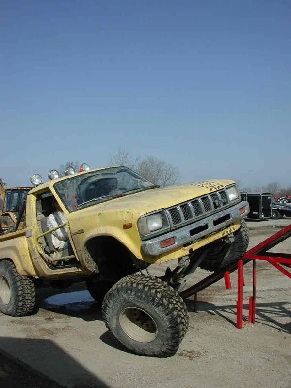

Here are a couple old pics of the truck, it now is a convertable and still has the tube doors like in the pics, I am doing a chromoly roll cage in it since the roof is gone and no more roll bar mounted to the frame though my bed- it will be in the cab and have kickers down into the bed.
