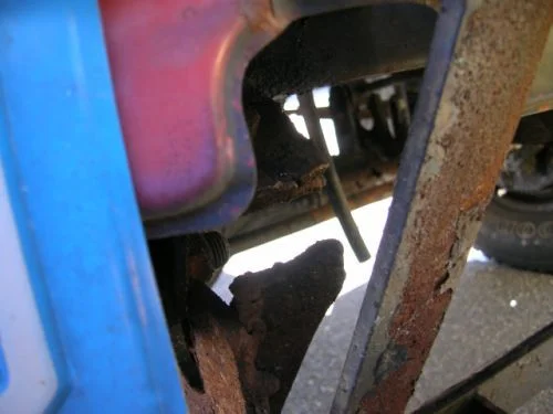

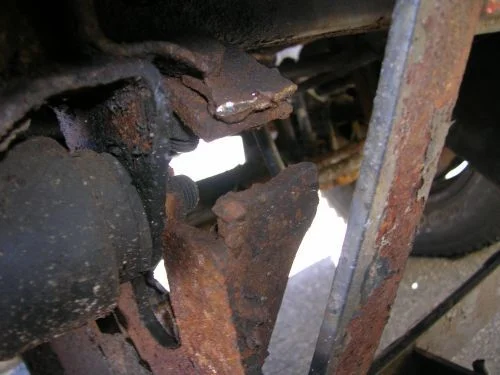

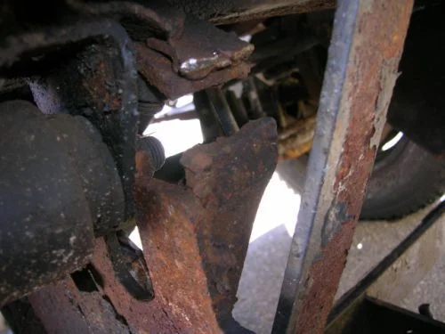

Below are pics of the plow frame on my 1979 4x4 short bed. While plowing yesterday I broke a weld. Any advice on how to fix this issue?
Thanks,
Zack

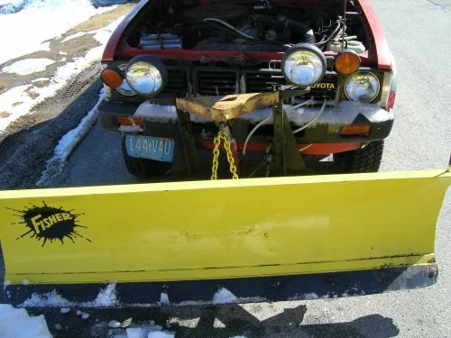

And last one, notice how much lower the pass side frame is.
Zack

ok so throw a floor jack under it and jack it up to the right hight and use a c-clamp or something to keep it tight and weld away... I might put an overhanging piece across the weld aftarwards and weld it on both sides if I were really paranoid about my welds but im not and it should be fine anyways.

It looks like it was pretty boogery to begin with..... Weld, plate, weld!

Pull it off, clean it up very, VERY well. Weld, Plate, Weld...
