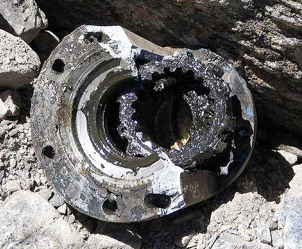

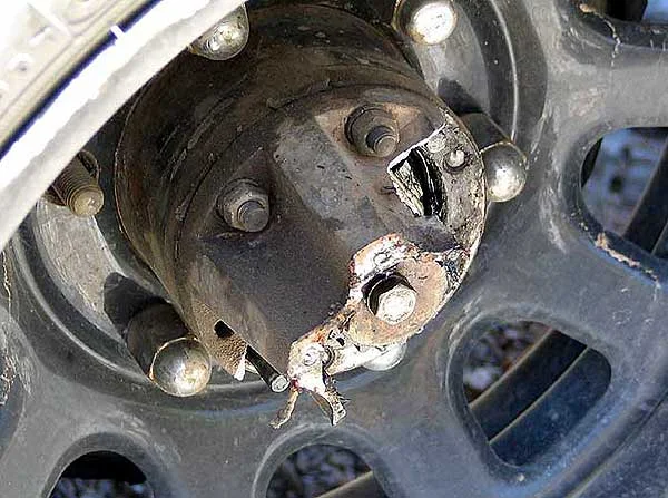

Yes they are one of the best for enhanced carnage! The are made from cast alloy, don't use cone washers to mount, so are mounted much less securely. The Aisin's are steel, more compact and much more solid.
This is the type of carnage that you can look forward to with Warns!

A buddies FJ40, it launched the debris (hub parts) into the rocks!
