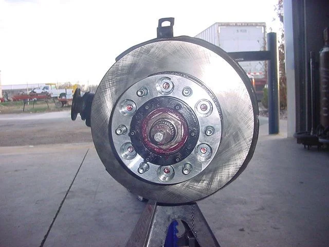

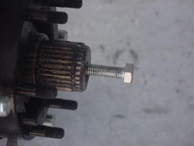

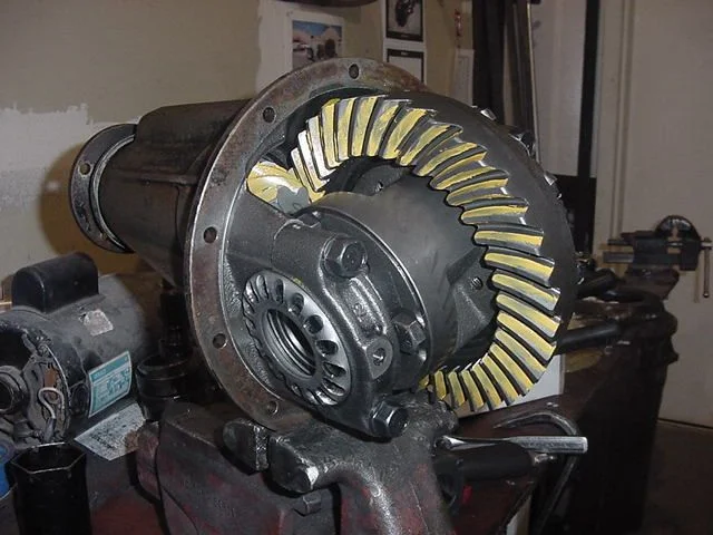

5.29 gears, and top veiw

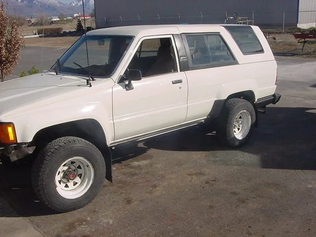

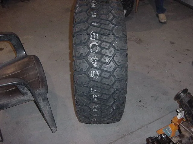

Tires.

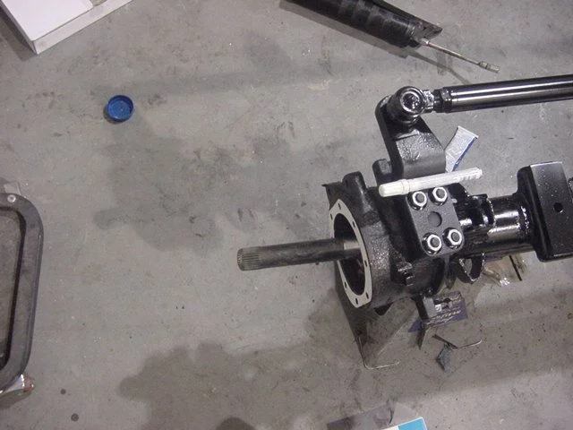

Old 03-17-07, 12:40 AM   #67 (permalink)
250+ Club
Join Date: Jan 2006
Location: West Haven, Utah
Posts: 358

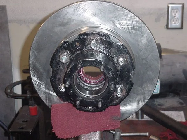

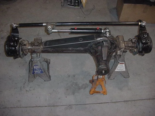

Primer, paint, Birfield Grease.

Old 03-17-07, 12:43 AM   #68 (permalink)
250+ Club
Join Date: Jan 2006
Posts: 358

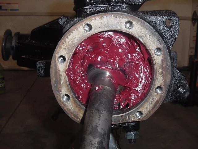

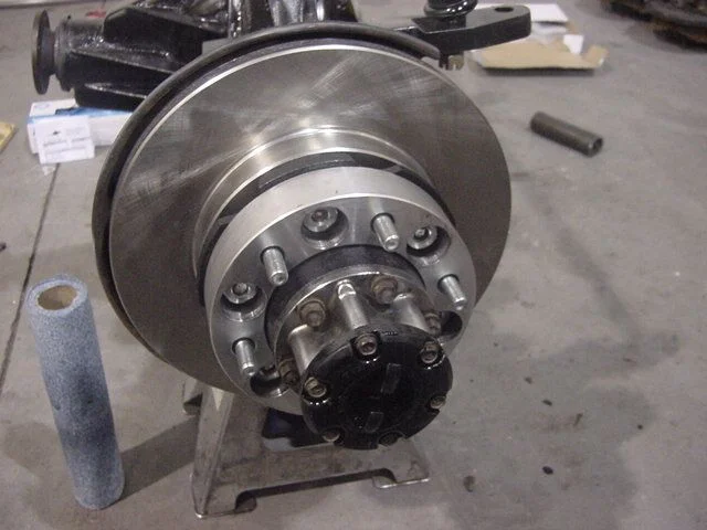

Knuckle Half Way Greased, Setting Studs, Done

Old 03-17-07, 12:50 AM   #69 (permalink)
250+ Club
Join Date: Jan 2006
Posts: 358

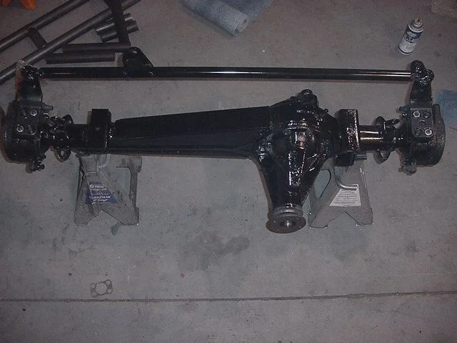

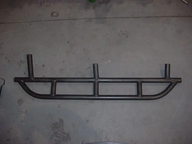

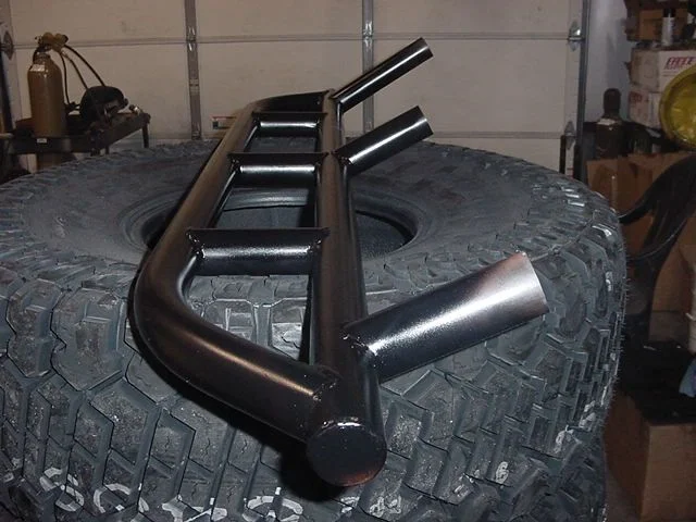

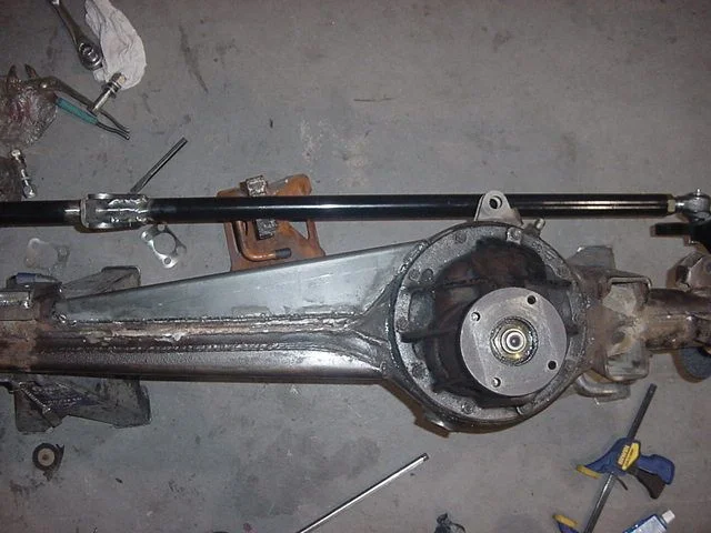

Sloder Supports Welded, Painted, And I Accidently Put Knuckle On Backwards ... So Now I'll Have To Fix That .

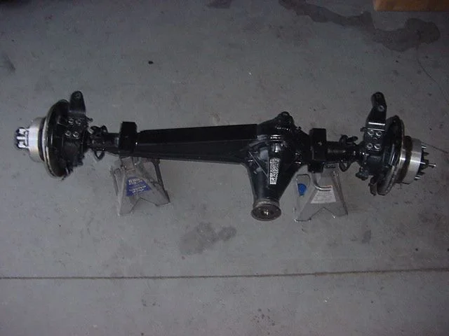

Old 03-19-07, 12:27 AM   #70 (permalink)
250+ Club
Join Date: Jan 2006
Posts: 358

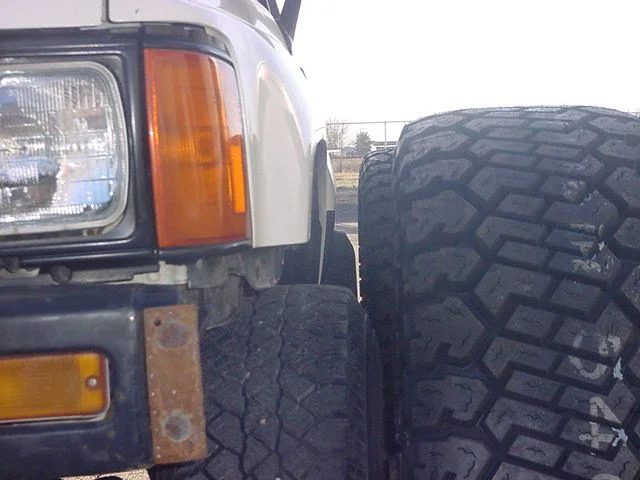

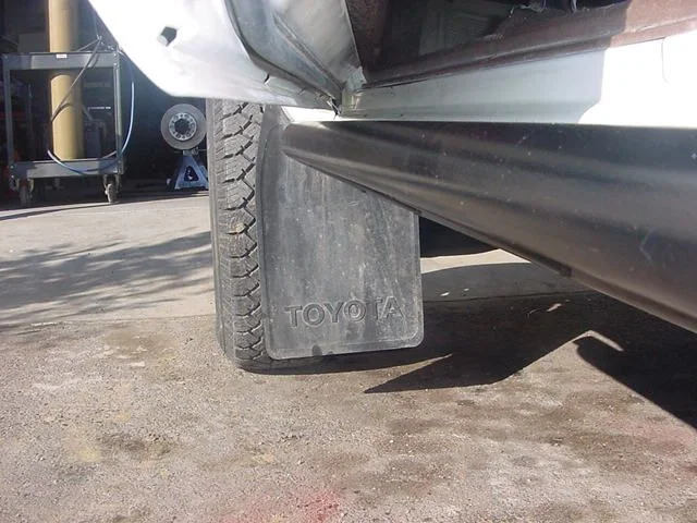

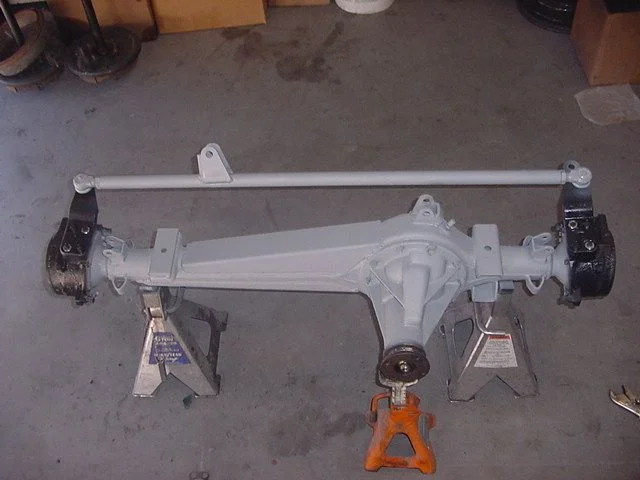

Ok, Did A Few Things Today....
Switched The Knuckles Around. So Now They Are On The Correct Way.
Finished Putting The Axle Together, Besides The Passangers Side. Missing Thrust Washer, One Spindle Nut. and I Think The C-Clip.
Fished Painting The Sliders, And Mounted Them.
Took The 37" Tires And Put It Next To The 4RNR. For Fun.
On Friday We Will Start Taking Out The IFS, And Putting In The Lift. We Hope To Have It Done By Sunday, Monday At The Latest. We Hope.

Old 03-19-07, 12:30 AM   #71 (permalink)
250+ Club
Join Date: Jan 2006
Posts: 358
more

Old 03-19-07, 12:32 AM   #72 (permalink)
250+ Club
Join Date: Jan 2006
Posts: 358
last one for today

Did you paint the steering arm surface on the top of the knuckles (and bottom of the steering arm)? If so, pull that thing apart and clean it all off. The paint compresses and you will end up with a steering stud maintenance issue.
__________________
Brian K. Gallus
bkg is offline   Reply With Quote
Old 03-19-07, 11:09 PM   #74 (permalink)
250+ Club
Join Date: Jan 2006
Posts: 358
Quote:
Originally Posted by Arya Ebrahimi View Post
Please tell me you didn't paint the mating surface between the steering arms and the knuckle? This is a friction surface and must be bare metal.
Quote:
As Metioned By Ary Already.... But No I Did Not Paint The Bottom... I Used Masking Tape. Also You Can Paint The Top. Notice I Welded The Studs, Plus There Are Cone Washers, And I Used Some Locktight Just In Case.I Do Plan On Gettin Some Six Shooter Knuckes Later On Down The Road For A Back Up Just Incase If I Ever Do Sheer Of Any Studs.
Thanks For The Question Though.
And I Hope This Answered Your Question And Then Some.

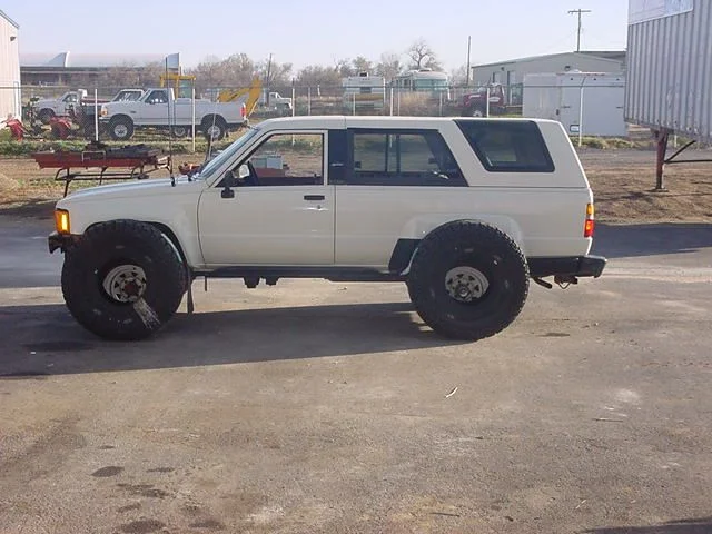

TOO COOL!!!!!!!!!!!!!
NICE RUNNER!
and NICE JOB!

Thanks ManAll I Need I A Front Drive Shaft, Then I Csn Go Wheel It. I Guess I'll Hsve To Stop By Tom Woods Shop.
