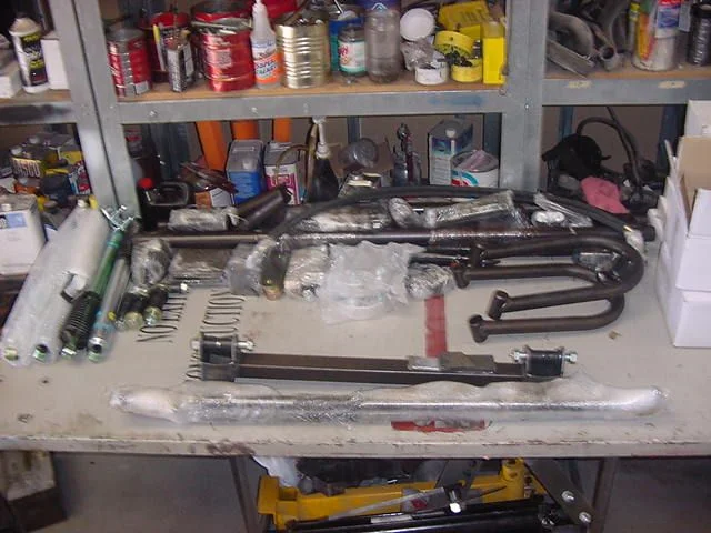

Just Bought SAS Kit, Rear Lift Kit, Hydrolic Assit, And Sliders From Worldwide Offroad.
Tires Should Be Here In A Week, Locker 2-3 Days; SAS Kit, Rear Lift Kit, Hydro, And Sliders Should Be Here By Next Week Sometime.

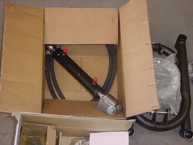

Alright, Everything Is Orderd And On The Way.

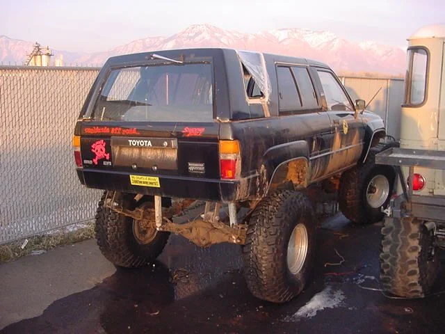

Today I Installed The Speedo Cable Since It Did Not Have One. That Was A Royal Pain In The Arse! And The Speedo Had A Broken Clip. So I Had To Rig It So It Would Stay In. But I Said I Would Post Some Pics... So This Is My Brothers, It Will Look Almost The Same... BUT BETER! And My Front Axle

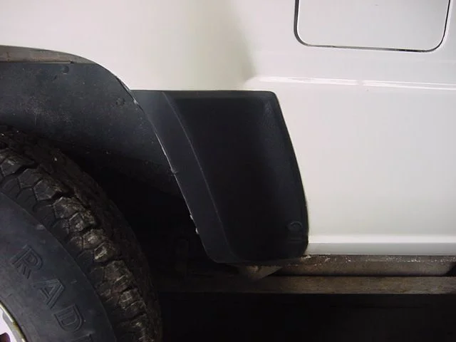

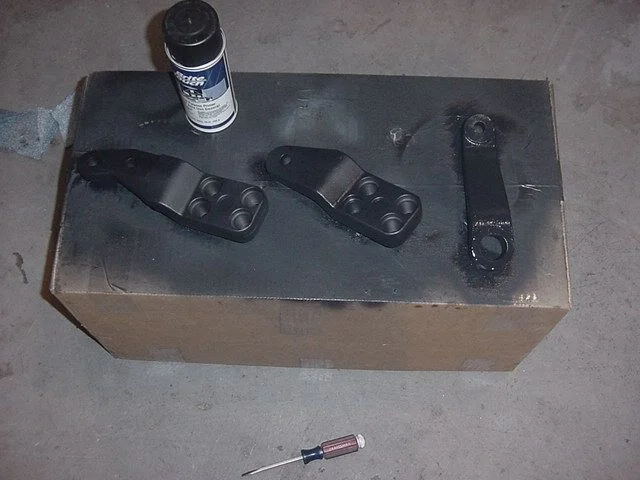

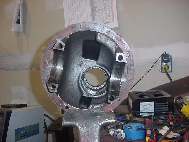

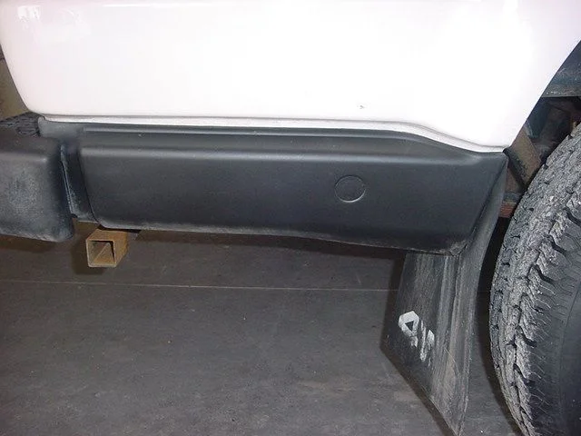

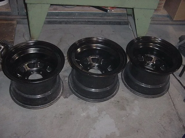

and My TRUE TRAK I Have Had For 3 Years... I Will Be Puting It In The Front Axle, Aussie In The Rear
And Painted Plastic Trim

Let me guess...... Your "Dad's friend" painted that plastic stuff? Hehehe Lookin' good!

Actually, I did It Was Fadinf To White From Sun Damage. So I Had To Paint It. The Rest Of The Truck Looked Nice... So I Had To Make The Whole Thing Nice

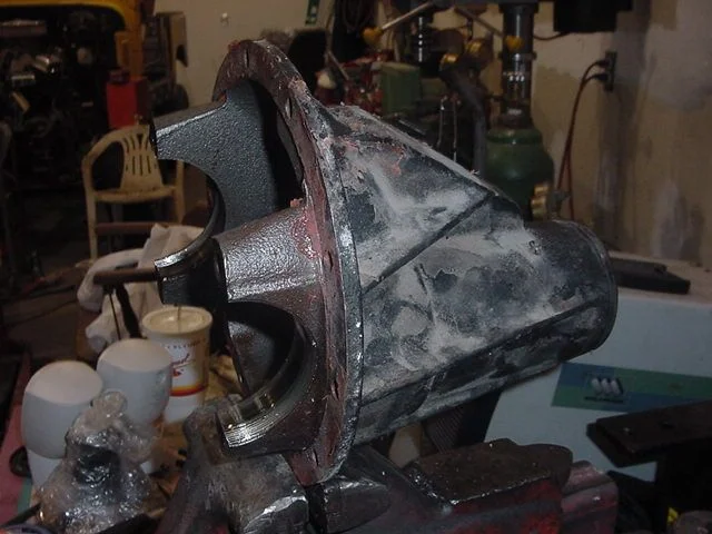

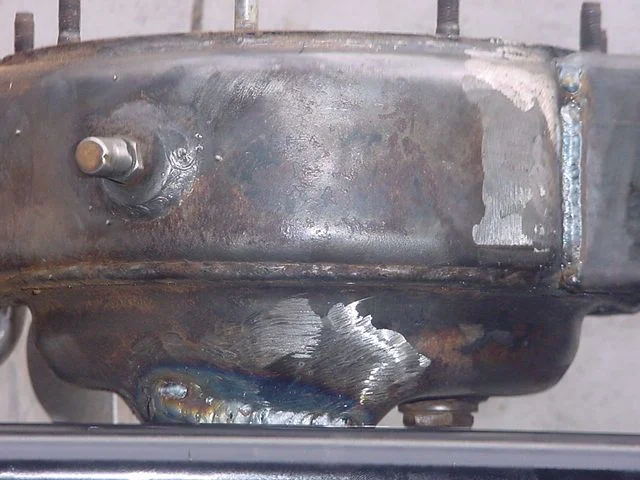

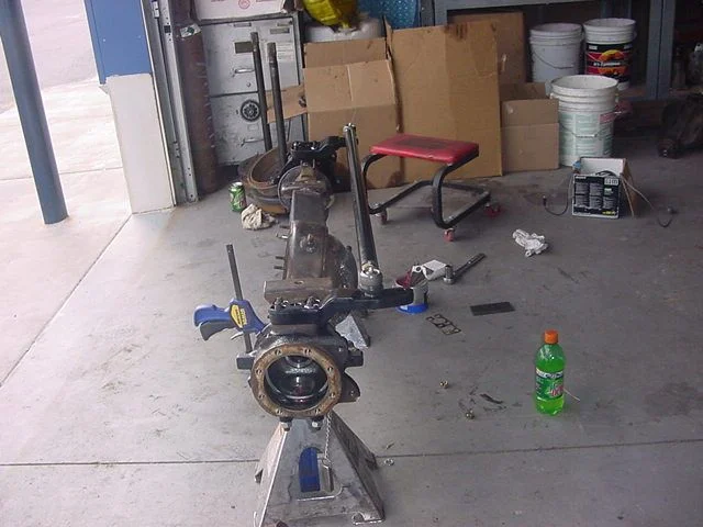

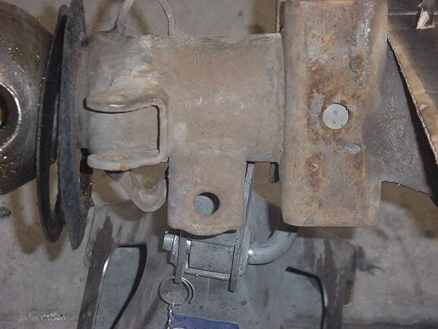

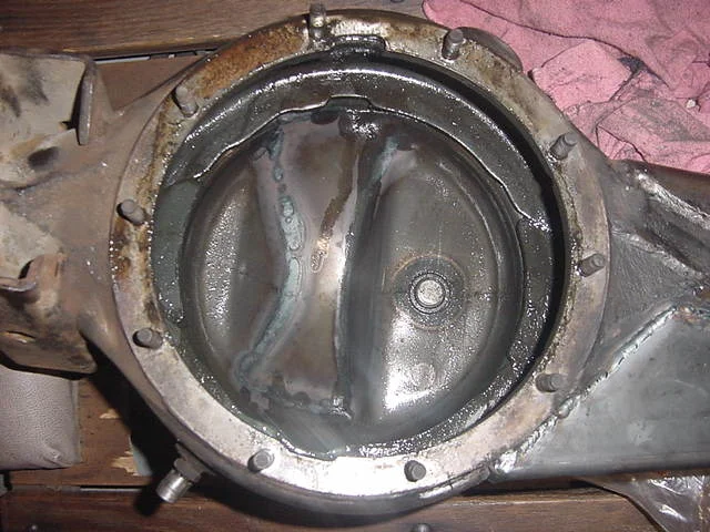

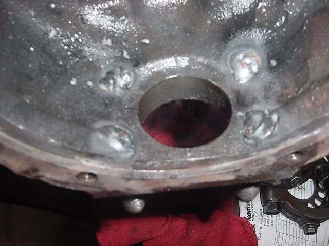

finished taking apart front axle, tore apart 3rd member, took off disc brakes, welded nuckle studs, cut off the traction bar, steering stabilizer bracket, and tortion bar brackets.
i did bring my camera today, so pictures will be up later on tonight.

list of things coming....
Hydrolic Steering Assist
SAS Kit (5")
Classic Rear Lift (5")
Aussie Locker
5.29:1 Gears
37x13.50x15 Dick Cepek Tires (Mickey Thompson)
Detroit True Trac (already Have, Going In Front)

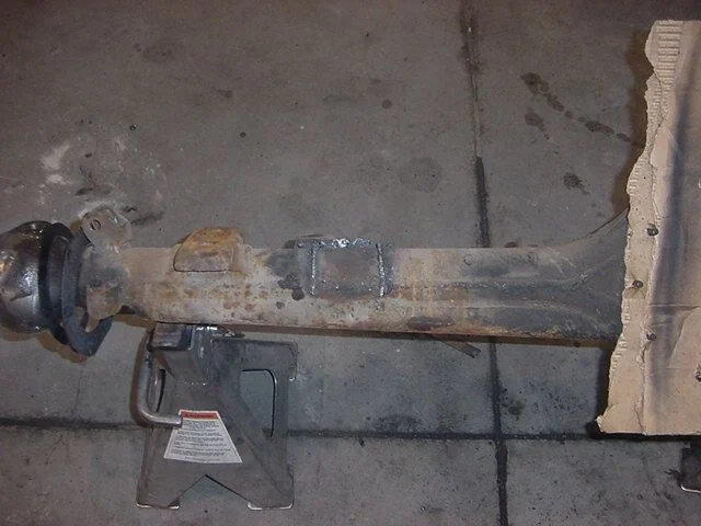

Pictures...
lmnop

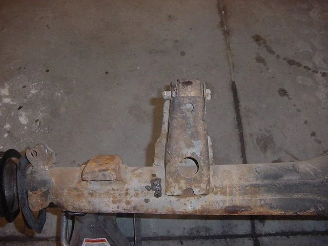

qrst

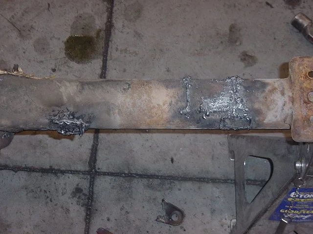

uvwx

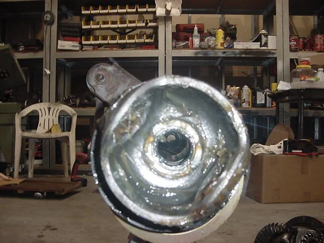

yz01

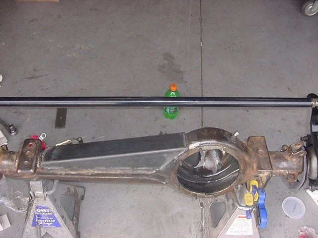

2345

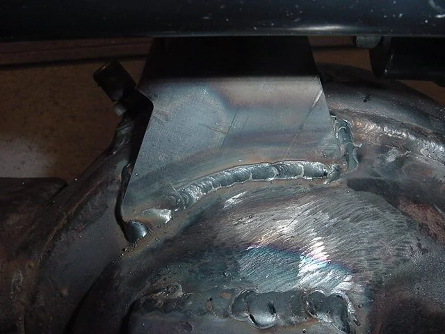

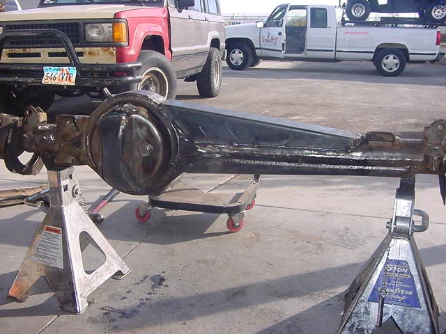

Are you gonna upgrade that housing to the 83/84 level of bracing? I would. Cheap and easy when the axle's not installed.

Quote:
Do You Meen The Gusset On The Bottom? If So...
It Is An 85 Housing (You Can See It In The Picture Below), And I Am Also Putting A Gusset On The Top Too.

Old 03-14-07, 12:25 AM   #53 (permalink)
250+ Club
Join Date: Jan 2006
Location: West Haven, Utah
Posts: 358

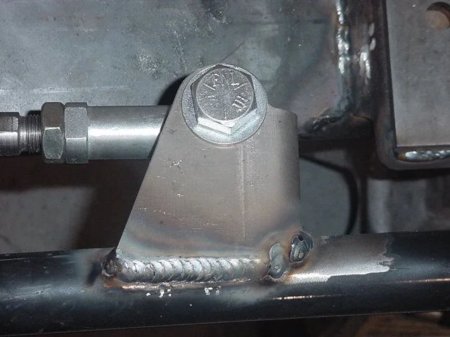

I Got My Suspension Parts Today!!!
__________________
Bullets For Blood
I Like Caps!
http://www.worldwideoffroad.com/
MyBuild Up:
http://forum.ih8mud.com/showthread.php?t=140640
Full_M3tal is offline   Reply With Quote
Old 03-14-07, 12:29 AM   #54 (permalink)
250+ Club
Join Date: Jan 2006
Posts: 358
Axle Top Gusset, And Diff Cover Protector, Then Welded, Steering Ams Painted (kinda Hard To See.

Old 03-14-07, 12:34 AM   #55 (permalink)
250+ Club
Join Date: Jan 2006
Posts: 358
Wheels, Knuckles, And Diffcover Weld Penatration

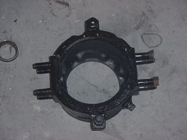

Old 03-14-07, 10:23 PM   #56 (permalink)
Forum Lifer
Arya Ebrahimi's Avatar
Join Date: Dec 2003
Location: Rockville, MD
Posts: 2,738
Please tell me you didn't paint the mating surface between the steering arms and the knuckle? This is a friction surface and must be bare metal.
__________________
HOKIES UNITED
Mobile Base Camp Trailer Build
Arya Ebrahimi
'94 FZJ80 220k miles, locked, 4.88s, 285 Revo's, ARB Bullbar, Hella 4000's, homemade drawers
'86 Toyota Pickup SAS'ed, welded, 4.88s, 38 TSLs, and lots o' tube
Arya Ebrahimi is offline   Reply With Quote
Old 03-14-07, 10:26 PM   #57 (permalink)
250+ Club
Join Date: Jan 2006
Posts: 358
Quote:
Sure Didn't.
__________________
Bullets For Blood
I Like Caps!
MyBuild Up:
Old 03-14-07, 10:40 PM   #58 (permalink)
Forum Lifer
Join Date: Dec 2003
Posts: 2,738
Good, some people just don't know

Old 03-14-07, 10:51 PM   #59 (permalink)
250+ Club
Join Date: Jan 2006
Posts: 358
ttt

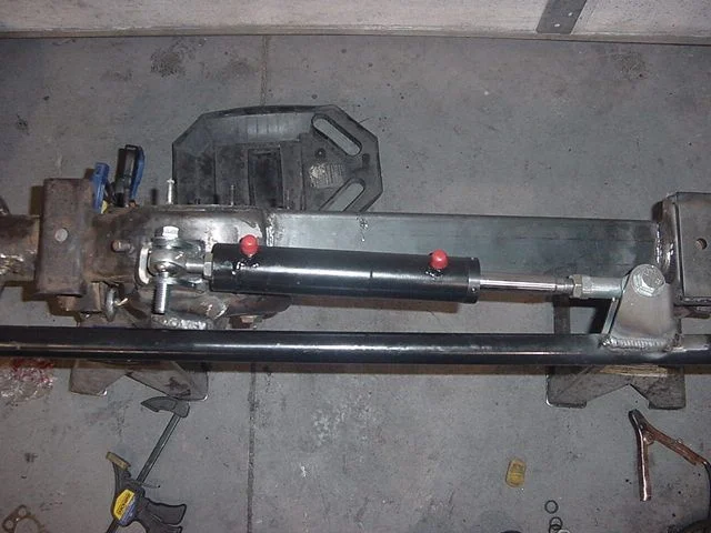

Old 03-14-07, 10:57 PM   #60 (permalink)
250+ Club
Join Date: Jan 2006
Posts: 358
hydro assit
