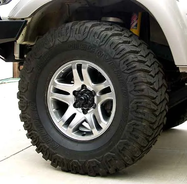

I have 37 x 12.5 Cooper STT's on Tundra 7.5's, only had them a couple of weeks, but liking them.
