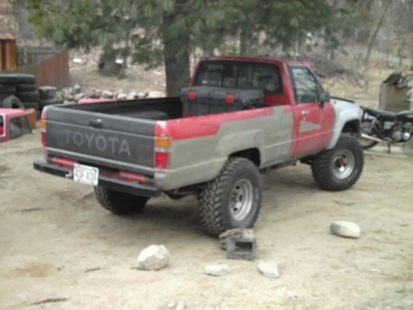

Spiffin up the back side a bit.

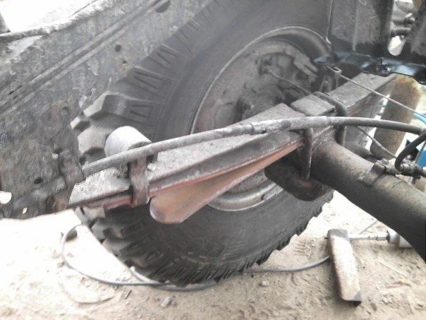

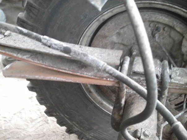

So im driving around with my buddy and he notices that the right side of the bed hangs a bit low. I tell him that it has always done that and its not a problem.
Being the thick headed kid he is he stuck his head under the truck anyway and low and behold main leaf spring failure. If it wernt for the double military wrap my axle would have been located somewhere on interstate 90.
It must have happened recently because it was news to me. Anyway we drove back to his place and for fear of my life it got parked till I could get some new leaf springs and stuff under there
Now it just so happens I had some spare parts lying around care of All Pro and Marlin Crawler for an occasion just like this.
Check it out the photos suck because they were taken late last night.

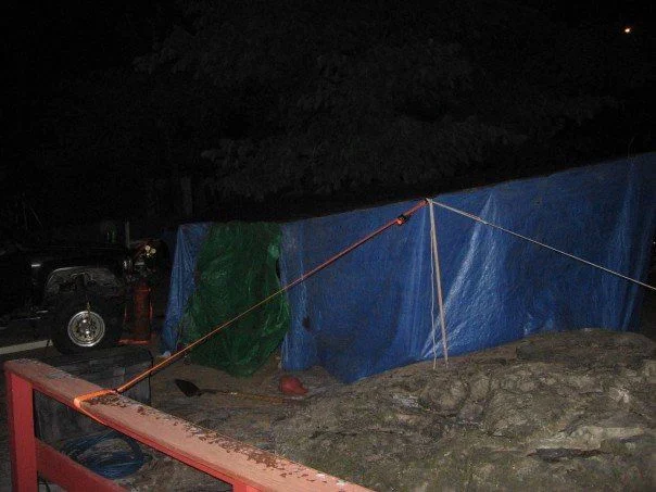

Why do I do all my work in the winter?

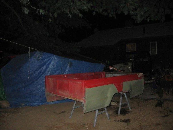

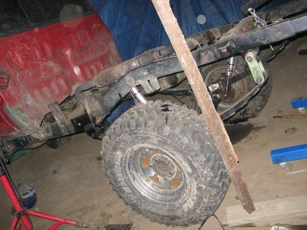

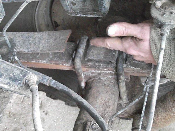

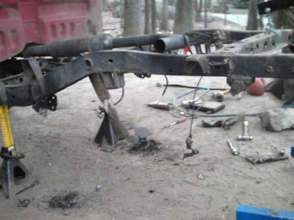

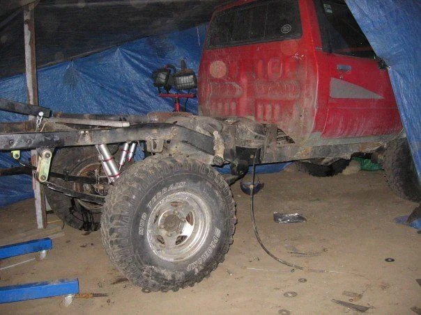

Here she is sitting under her own weight with the new springs

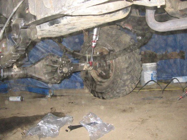

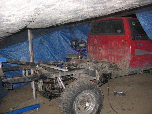

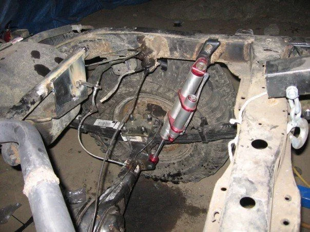

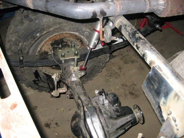

Here is the new axle and shocks. (3rd member care of marlin crawler and a boat load of mulah!)

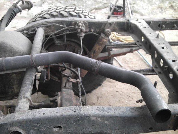

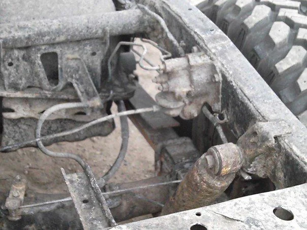

I have routed the exaust above the frame and lifted the gas tank 2 inches so that I could end up with a fairly flat underbelly from the t-case back. Eventually Ill loose the t-case suport and build my own so I can plate the entire underside.
Also to note I used the stock spring perches for now because I dont have all the parts I need, but once I get my hands on a short drive shaft and a carrier bearing im going to rotate the axle upwards and use a short cv style driveshaft to aim the shaft outa the way of rocks.

Thanks those are all pro's 4 inch long travle leaf springs and my back end was down about 3 or 4 inches anyway so I got about 7 inches outa em.

So where's the pics of the broken leafs?
Also that is a pretty shallow angle on the shackles......

I left the shackle angel shallow on purpose. My truck doesnt even have an anti sway bar wich will tell you how much I care about its ability to handle the road. But I do care about getting as much flex outa em as possible hence the shallow angle and johny joints on the shackles.
Like I said it was late last night when I took the pictures and I didnt know wich scrap pile the leafs were in. I also said there are more to come so just hold on there buckaroo im sure we can work something out.
You lost me here.....explain how a shallow shackle angle gives you bad handeling and better flex. Shackle angle play little roll with these trucks in regard to handeling, was is a factor is length. There is a compromise in angle for a reason, less angle=less drop but more up and vise versa. So you're telling me you don't want drop but up travel???

the angle looks alot worse beacause of 2 factors 1 the bed is no there yet so the added weight is not on the frame/ leaf spring 2 the springs are brand new 0 miles on them so they have not settled in, once the springs have some miles on them and the bed is on with its usual 150 pounds of cargo that angle will become less extreme
all pro says to move the rear hanger back 1 1/2 to 2 inches we moved it 1 1/2
true true but it seems to me if the springs have to settle that much for a good angle with just the weight of the bed they are inline with suck-o downeys. All pro is not a name I would doubt at all. I'd say keep an eye on them after a few weeks and you could grind off the mounts and move them to get a better angle if you feel you want it.

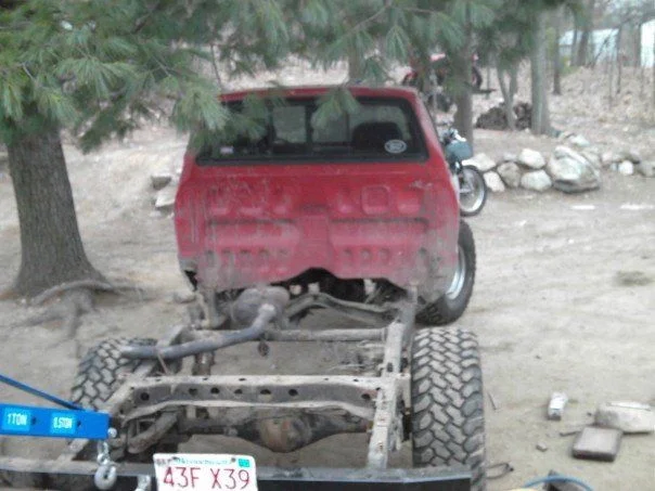

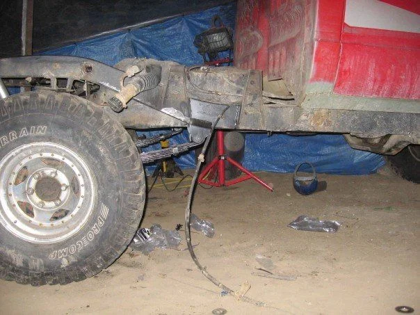

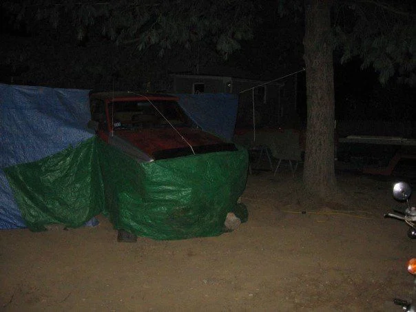

Ok I have some more pictures for yas guys, but your going to have to forgive me for some of the poor quality photos these shots came off of a dinosaur of a camera.
Also all these are all before shots of the above aftermath.
ok here goes

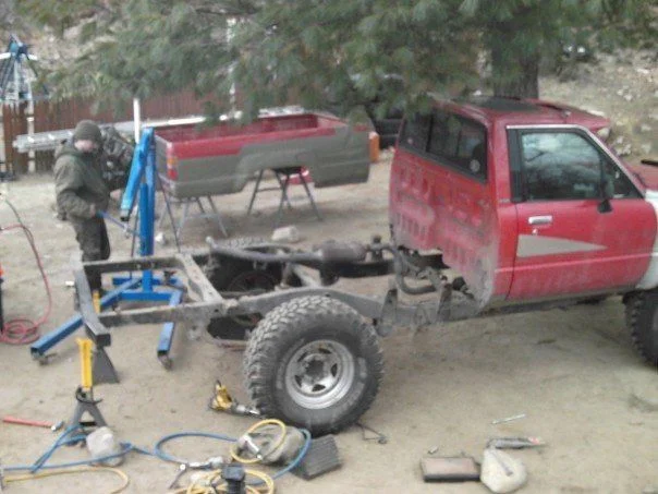

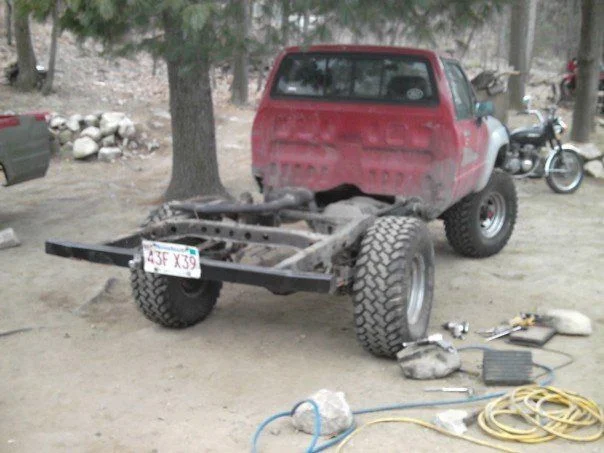

Gas tank out and nat workin the crane.

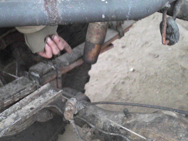

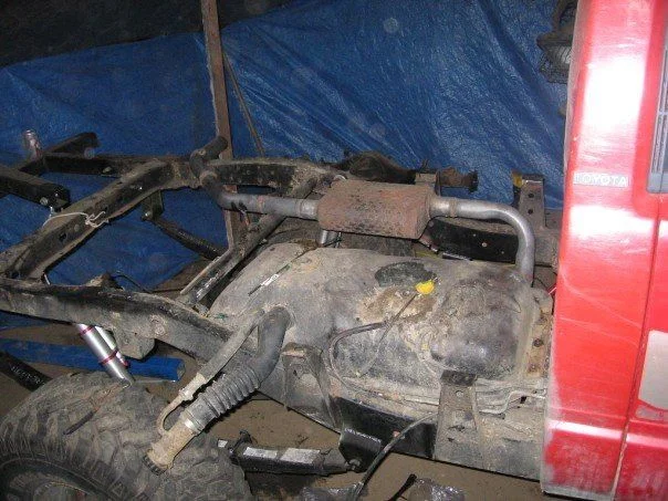

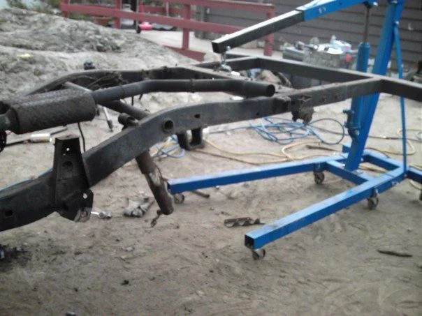

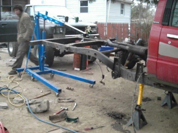

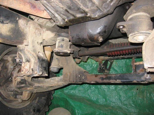

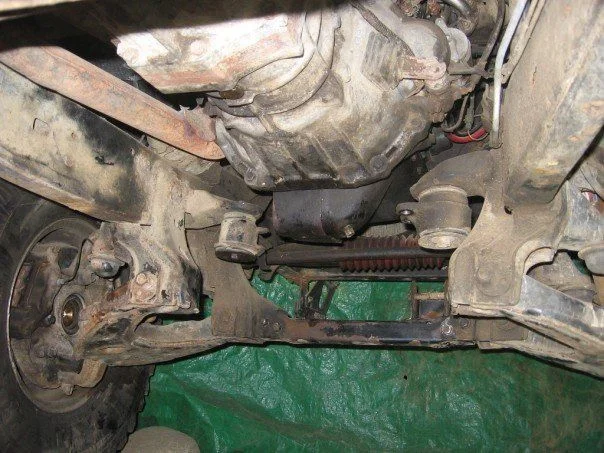

Cant see anything in the first photo, but see anything wrong in the second two shots?

Let me give you a hint

This thing must have chucked its valve rod to help me save some extra weight. Works well first 50$ gets it.

Here she is under the knife. The rest you have seen above and for the near future a newly redone front diff with 4:88 gears gets slaped in and the locker gets wired up...
coming soon.

Ok so the other night I stayed up late and installed the new front diff. Nat and I had rebuilt one of the spare front diffs he had lying around with brand new yukon 4:88 gears.
While we were at it we riped the hubs off and rebuilt those... again. Seems that the gasket surface was worn to shit and let wattery goo into one of the hubs. (no wounder it was so hard to turn) sry no pics of that tear down.
but while all that other crap was out we replaced the bronse spindle bushings that were making my truck into a giant vibrator. (the gf said I should just keep the crappy ones in and sell rides to horny college girls from down the street)
and earlier tonight we got the wireing roughed up and working. here are some pics of the diff comin out and about to go in.
