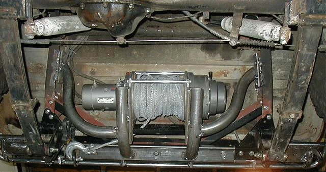

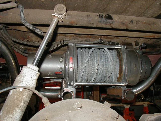

Rear winch pics - M12000
The tube frame that the winch is mounted to is bolted to the frame rails and the rear cross member. More pics later...

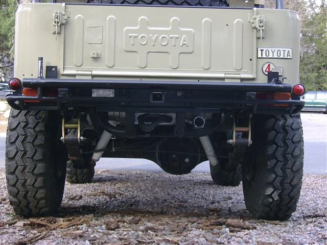

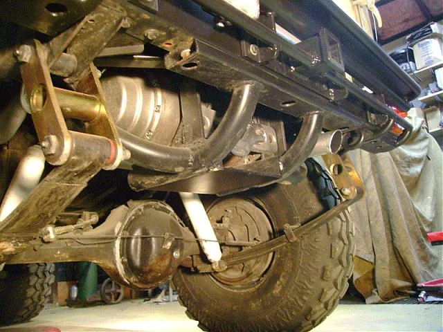

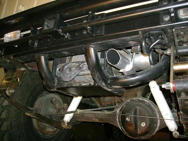

last two pics.
