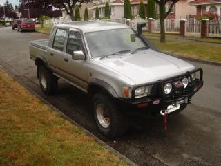

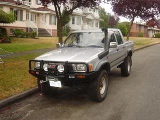

Hey any of you aussie guys have pics of a bobbed 1990 Hilux crew-cab pick-up.
Been trying to figure out if i should go bob it or do a flat deck...

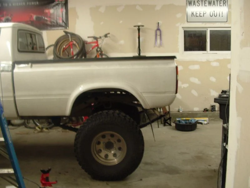

Here is a pic of my '82 bed that I took 14" out. The top lip is not bad just build up you weld and grind it smooth . For the cut across the bed I drilled a small hole through the outside sheet metal right above the floor of the bed on each side, ran a string across and pulled tight, and then lightly spray painted the bed over the string. Remove the string and you have a nice straight line to cut on. I agree with extremetoy1 measure, check, double check and cut. Take some pics and do a write up would be great to see it done.
AWSOME job! looks good-the rocker/rear roll pan area looks good too!
I will post some of the 89 bed I did (for a friend, FREE believe it or not!)
how did the inside of your bed turn out? if it werent for the double wall be of the 89 it wouldve looked like poop! the inside of the bed actually turned out incredible, but we had to "work" the outside edges where we welded it back together inwards where the weld was so we didnt have to grind much down.

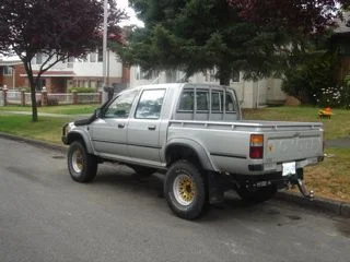

Bah! That's only about 65*..... Call me when you break 90*!!!
I'm using this to put a picture up!
