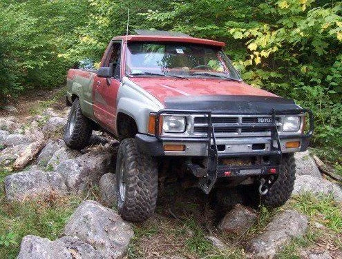

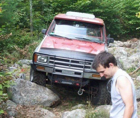

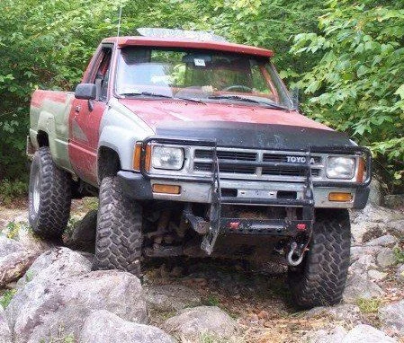

Your right I have no experience with anything to do with independant front suspentions.... wait a second is that an IFS under my truck?... couldnt be... Oh look 33" tires I must have cramed them under there with ball joint spacers. Wait a sec I dont see any spacers down there whats going on? Oh thats right now I remember I might have a little bit of experience with this set up and what I know is you can fit 33's easy if you jack the tortion bars. You dont want to hammer them home because itll stifn them up too much but if you do like I did and just get those a-arms down till the bump stops are just touchin your suspention can flex fine. (btw i never said go buy big stiff t-bars I said buy a set that will allow for a flexy suspention. and I know for a fact you can find em.)
bear is right that you need to have a plan, the best way to figure this out is to ask yourself what capabilities you want your truck to realisticly be able to handle on and off road. from there its just time will and money.
but my .02 is not to buy a drop bracket ifs lift its got no real positive aspects other than you can look cool with larger tires under your truck.
but im sure that my opinion looks silly from some other points of view so take it with a grain of salt and figure it out.

So what's your point with the link Nate???? The short about the Total Chaos kit?? Seriously if that is the exent of your reading you need to do more before telling someone total BS here. PLEASE show me where it talks about the larger t-bars NOT limiting travel. Bottom line is if you are using the stock A-arms and their geomerty any bar larger than stock will KILL your designed travel. PERIOD. Been there done that. Even with my long travel kit, larger 25mm t-bars SUCK compaired to the stock bars in regard to flex. On the street and high speed it's a COMPLETELY different story.
I just have to add this also. In your pics I see no front wheel travel and you are traversing the rocks down hill, which usally loads the front end and forces even stiff springs to flex. If your front doesn't flex with it's loaded it an't worth a s**t. If you can get the front to flex on a climb, unloaded then you are gaing groud.....like this:

Quote:
Originally Posted by Bear80 View Post
N8, I was not exactly trying to personally attack you. However, there is NO SUCH THING as flexy torsion bars other than the stock bars. If you know of a set or brand PLEASE let me know. And if you are ridding with your truck toped out on the upper a-arms you haven't been around enough. 33" tires will fit on a STOCK truck (possible pinch weld hammering needed), with the t-bars adjusted up maybe 1", no where near what you are recommending. From your pictures you also have zero front wheel travel which is useless. Just cause you have an IFS doen't mean you know what your doing.....
Wow someone forgot to take their meds . I believe what N8 was trying to say was that if you are cranking your stock torsion bars up for added lift that you are going to add to much preload to them making them stiffer. If you upgrade your torsion bars you add ride height and since they are NOT preloaded you get a much flexier ride from them. Larger torsion bars also help bottoming out after you have crested an obstacle.
I have them on my 4runner and am very happy with them they help allot with the added weight of the ARB and the Warn winch
I have wheeled with N8 in the past the truck does flex like the one in your photo you posted, those pick he posted were not very good for his description I will check my computer later for some proper photos of that trucks flex
