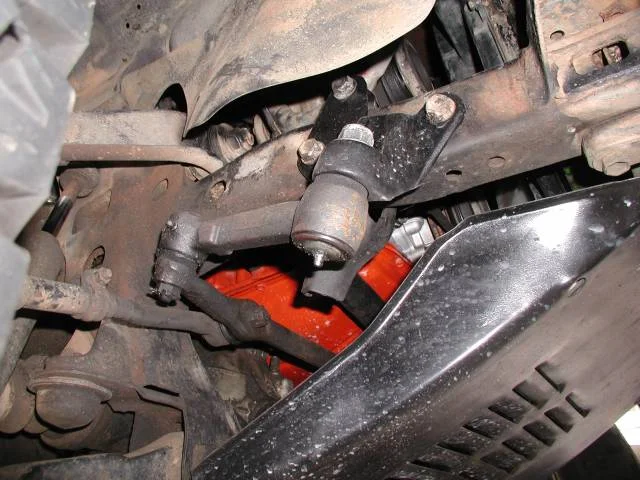

Screw the factory arm. Its weak and bends easily. Autzone sells a beefier unit for about what the dealer will rape you for the bushings. It is twice the diameter at the pivot and the arm. It is greasable as well.

Grim, no offense but that arm is the biggest POS. If anything get a stock arm, replace the bushings and get a gusset. I went through 2 of those crap arms, they allow for upward/downward travel which is NOT what you want, the arm should only move left and right.
If you think the dealer prices are too high, you are mislead. The dealer prices are way fair for the quality, and if you do enough business with one they may give you a 20% shop discount, or just order parts through CruiserDan

I have seen three bent factory Idlers on three different stock trucks. The shaft is thin and they bend right where the go into the bushings. I can even tell you how it happens. Extend the suspension on passengerside, wedge the wheel while turing right. Good chace ytou will bend it about guranteed if you have a suspension lift.
Even if this is junk It has a lifetime warranty that the factory unit doesn't. I'll stick with my $59 unit and get new for free as needed. Its been on nearly a year and 2-3 trail rides so far so good. I Check it and give it a shot of grease every oil change or after every trail ride. So far no play.
