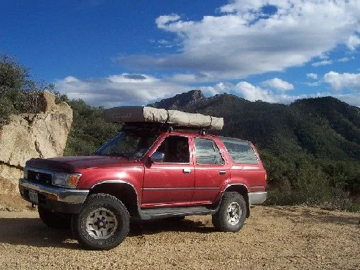

what the sag correction looks like
i don't actually know what kit this is- the original owner put it on (i'm the 2nd owner). This is parked uphill, with a bunch of crap in the back.
