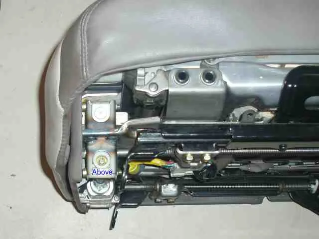

about a year ago my passenger seat would go forward but not back so pulled it out and set it as far back as itd go and put it back in with the electrical disconnected. then a few months later i found the little plastic cap had fallen out on the driver side and then had the same problem witht he seat, put two and two together replaced the cap and drivers side worked great. sooo the problem is i lost the plastic cap for the passenger side. A buddy of mine came over for dinner the other night and was complaining about how his passenger side seat was broken and how fabric must be stuck in it b/c he's pulling all kinds of fuzz out, so i bet on the same issue, pulled the seat out and sure enough no cap, so i moved it back and put it in w/o electrical and showed him the cap he was missing. now with two missing caps im willing to hunt down the pieces or order them from dan. does anyone have a part number for these pesky little things? or do you have to order the larger white unit including the piece? also what is causing these to unscrew or dislodge? anyone know i did a search and someone mentioned glueing them back in, but others pointed out they were threaded and glueing wasnt touched on further.
thanks in advance guys
