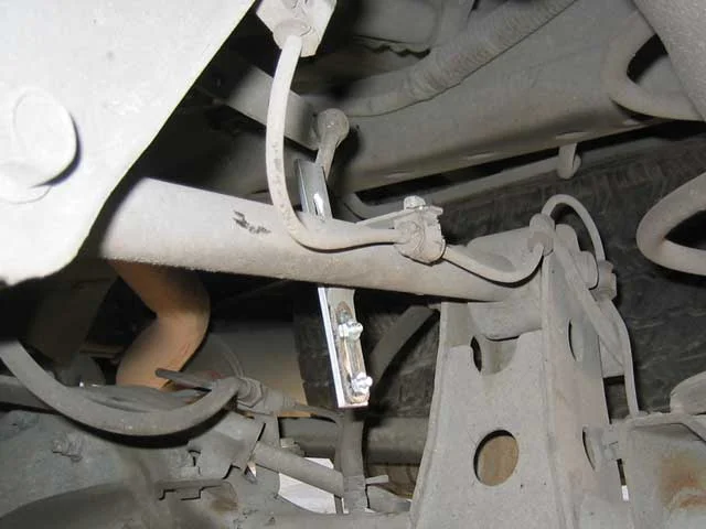

Added some pics. The first one shows the shortened heim joint. Notice the two stop-nuts are removed. The second pic shows the simple bracket made of of 1" aluminum stock. The new mounting point is slotted like the original.
