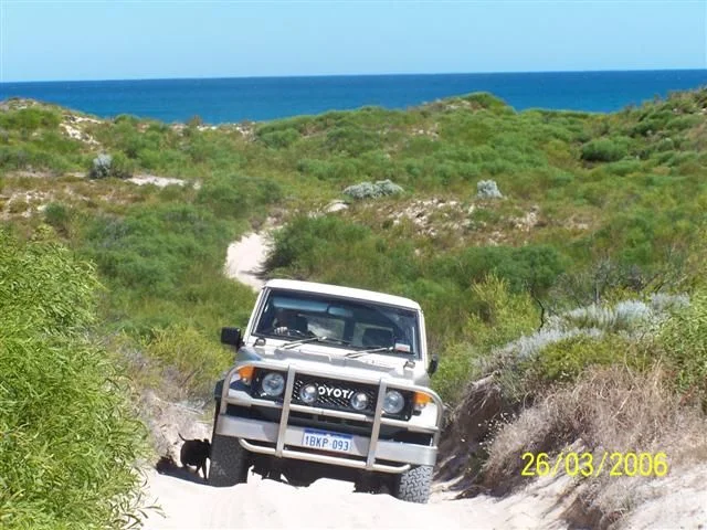

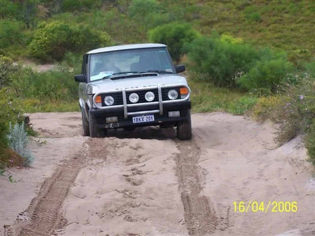

I do nearly all my off road driving in terrain like shown below. Ive found found the BFG t/a are tye best without going for a specialist sand tyre.The MT break the surface.
The RR had geolanders and got stuck on the beachLOL
Ive looked at the Coopers but I see a lot of mixed responces on various forums.
I do zero rock and gravel terrain,there just isnt any around here that isnt locked away in national parks
