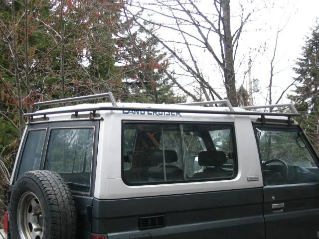

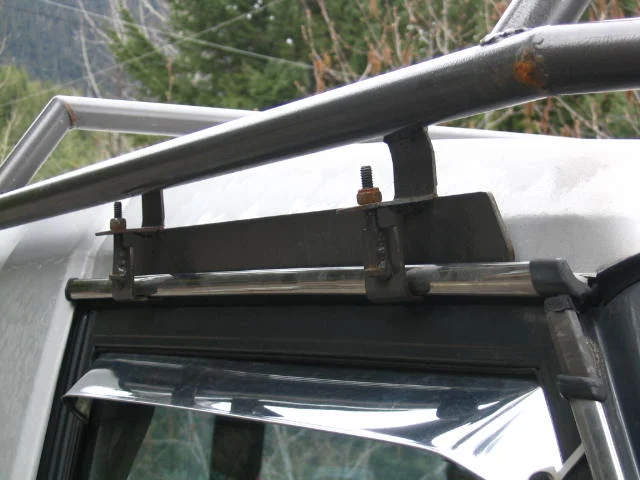

Here is my solution - not exactly heavy duty, but I think it spreads the load more than the Thule / Yakima type rack.
I used 1" tubing, and not having a bender, I cut and rewelded which added a lot of work. The supports are 1/8" flatbar and angle, and the clamps were bent to shape using a little attachment for use in a vise that I bought at Lee Valley Tools. Bolts were welded on and pass through holes drilled into the supports, and secured with lock nuts.
Since my welding experience consists of a night school course about 20 years ago, and I hadn't welded since, I'm quite pleased that it hasn't broken... yet! I will clean it up and repaint it, and I need to re work the clamps a bit as they come closer to the top of the doors than I like.
By design, it's very low profile, adding only 2" to the height, and not too much wind noise. It's probably fine for the odd bit of lumber, kayaks, and bikes, but for anything much heavier I would want a better solution. The windshield hinges and the lip under the FRP top would be my choice, so when I lift the top off I'll make some patterns to bend up some brackets.
Now, I'll try to attach some pix. Hope they help.

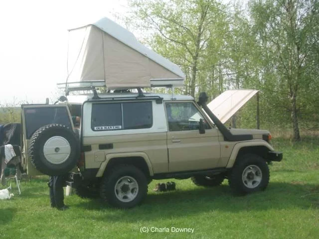

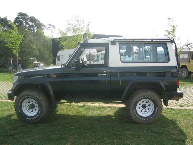

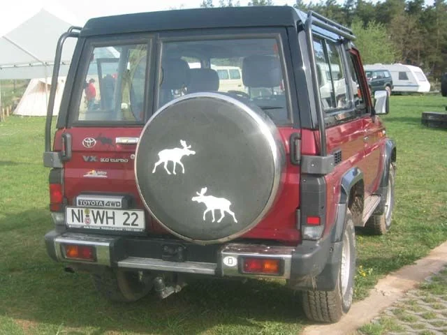

Here are a few trucks with similar set ups. Saw them in Europe. Maybe it's a package....

Charla...I love those! Will be filed away for future reference when I'm ready to make a serious attempt at a roof rack. Thanks!

Charla,
thanks for the cool pics.
i like the way the bars are attached to the body in the rear but i am not sure i like the way they fit into the hard top sides in the bottom pic...

Thanks for the pics Charla,any idea who makes those?

I also wish to know who makes them. Seems like a great solution to the FRP issue.

It also looks like the only system out there that I can use on the rag-top.

RE: Your question in the other thread...
They're Rhino Racks and i've had 285 kg sitting on them with my fat ass up there too. They don't seem to flex the fibreglass, but if I was travelling I wouldn't carry more than 150 up there due to the movement of teh weight and flex.
Across teh centre bar I had to put a big bit of rubber underneath it, wedged against the roof of the car because the bar bends under weight.
I love them, all my lights are mounted off them too
