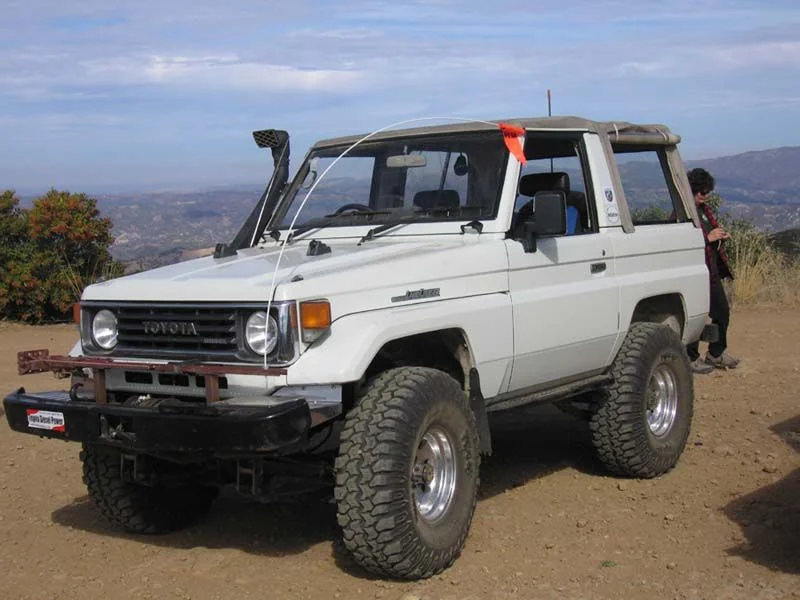

With skinny tires and rims you may even be able to get away with 34" tires. This 75 series is running 34x10.5x16 Swampers with stock factory suspension.
Dave

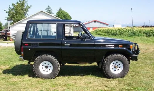

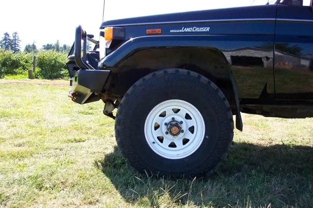

Nice Dave!
And here's a pic of Greg's BJ74 sitting on 35" SSRs:

Greg and I both run 255/85r/16 as daily on road tires. Greg has those 35" SSRs for wheeling. I definitely noticed a significant decrease in acceleration going from 32" tires to the 255/85r/16 (33.3")...but the 13B-T, H55f and 4.11 combo will do fine with 35"s, as mentioned by Wayne.

shoot... how did i miss this thread?
Dave, that 75 is awesome with 34 swampers. That's what I want to run on my 70.
Dave
Wow Dave!
That is one nice looking 75.
Left Hand Drive too!!
Hey wait a minute.......................... it looks oddly familiar now?
I bet it has A/C too right?
The 75 sure does look good wearing swampers now, Dave
Could it be your truck?????? Hmmmmm?????
Dave

I dug up a pic of my 70 with Greg_B's 35x10.5R16 swampers. Here's how the front looks with OME mediums, ARB bumper and 8274. That front axle would look a lot better about an inch forward. I always meant to ask Dieselbigot if he had repositioned his on his 70.
I remember hearing that Emu leafs were hellaciously hard to drill. Anyone done it?
