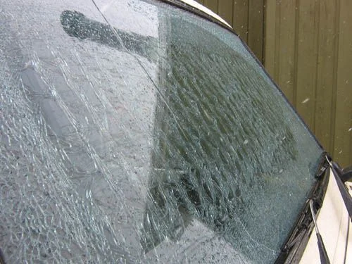

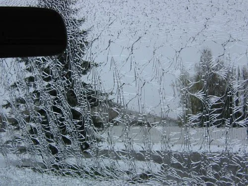

I've been noticing that some of the JDM rigs are coming *without* laminated glass in the front windshield. This means you are going to be wearing a lot of glass if you take a decent rock hit. Somebody should look into a group buy on replacement glass to see if we can knock the price down a little.
I'm amazed at the flagrant safety violations that get past the inspections.

Safety glass is *not* laminated. Safety glass is what is commonly found in side windows of automobiles. When it breaks it explodes into thousands of small... safe... pieces. Laminated glass is two sheets of tempered glass with a thick plastic sheet glued between. It stays generally in sheet form no matter what hits it.

I think the discussion started a few years ago on the diesel list shortly after Darren started the whole JDM importing craze. Its the fold down 70 series windows that seem to be in question and it came to my attention again after I had the glass removed from Ratpuke's BJ73 for painting. The glass fitter noticed it.
Her glass says Toyota Zonelite which apperently is "centrally tempered" glass possibly made in India by a large OEM supplier named Asahi India Safety Glass Ltd.
