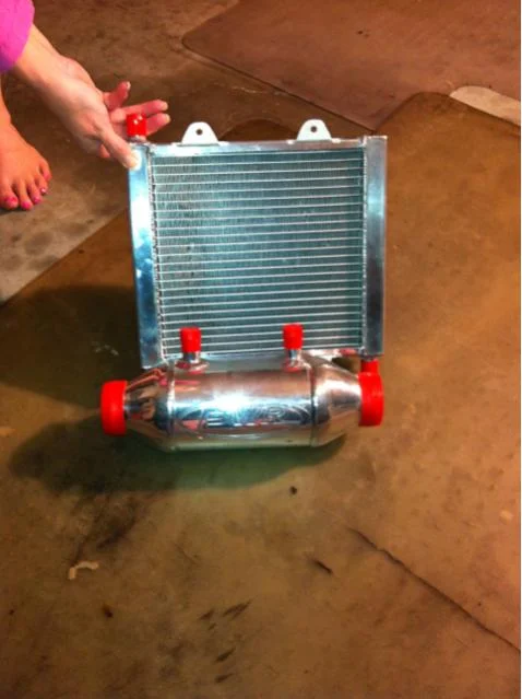

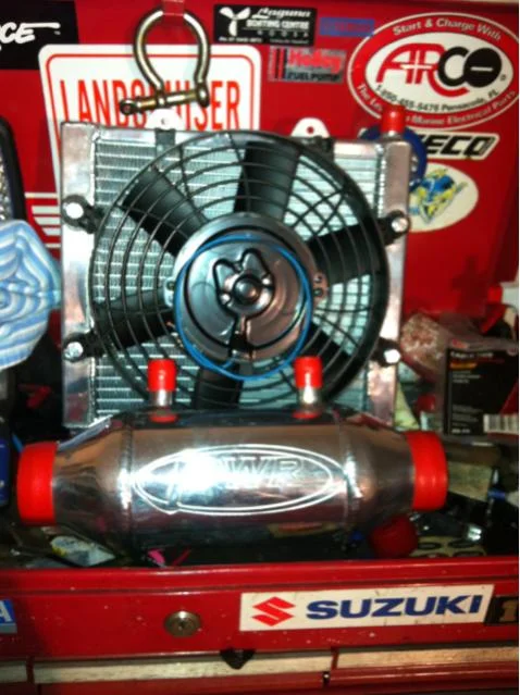

It arrived and im into the install.......
Sent from my iPhone using IH8MUD

Reckon small in size from the look.
What is your dimension of the intercooooler??

The inlet or barrel diameter?
cruisers75100 is offline   Reply With Quote
Old 01-27-12, 04:30 AM   #16
250+ Club
wongtsenhin's Avatar
Join Date: Nov 2010
Location: Sabah,Malaysia
Posts: 758
inlet and barrel
