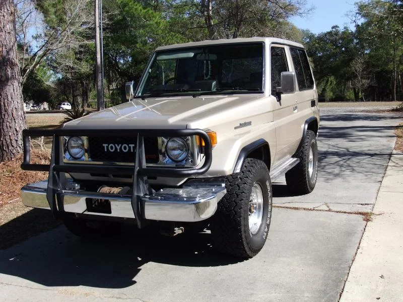

A funny although totally unrelated story........The gentleman who bought my 1988 BJ71 ( who had previously owned a Canadian BJ70) had taken the Cruiser to a local garage because it would not shutdown. After considerable trouble-shooting the garage finally ran out of options and called me to see if I had any input. Here is the good part....the current owner had noticed the turbo timer tucked under the steering column and after seeing the on-off switch ( which was selected - off ) thought it would be a good idea to turn it - on to see what it did. Guess what .....it worked.

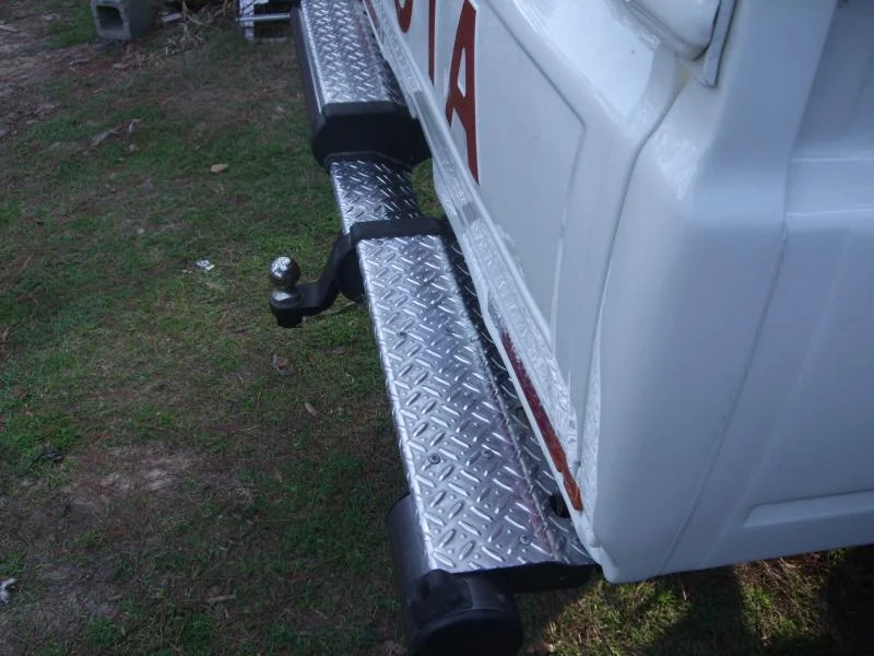

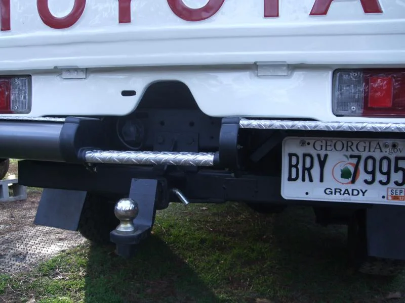

My shiny new bumper ( thanks Matt ). Can't wait to go to my local Walmart tomorrow so I can back into a "trail rated" Jeep in the parking lot.

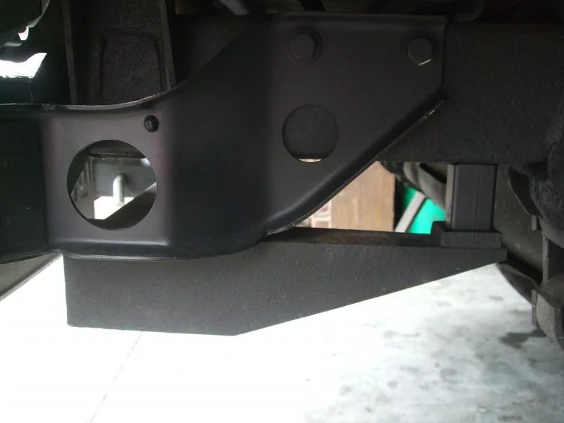

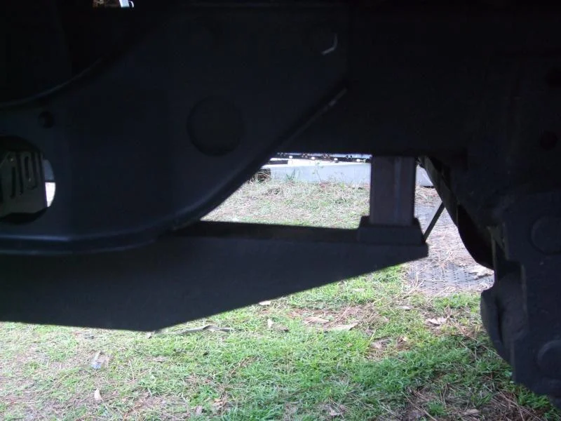

The metal frame that holds the trailer hitch receiver had to be lowered approximately 2 inches to accommodate the rear bumper. Small spacers ( photo) had to be installed to re-anchor the brace. Still have a little painting to do but basically the project is now complete.

I was just about to ask that question,my shiny new towbar and hitch is almost identical to yours and sits hard up against the frame.
Whats the towbar rated at,mine is 3500kg

Does the towbar / hitch appear to be factory? I assumed it was "aftermarket or homemade" because it interfered with the bumper.
I am not sure of the towing capacity...each of the forward "anchors" contains a thumb size nut and bolt so it is very secure. I don't pull anything larger than a small lawn mower trailer anyway.

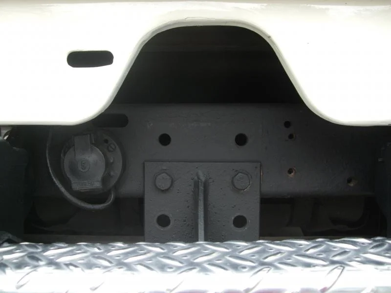

You can tell from the 2 "empty bolt holes" just above the center step , where the hitch was originally attached. We had to settle with the remaining two bolts and the forward anchors. You could do "pull ups" on either corner and there was no movement so I think we are good.

I dont think many owners here have a bumper like yours and most people ditch the factory tub in favour of the tray which would render the bumper useless for climbing onto the back
Toyota have a towbar as an option ,but Im not sure it was available in your utes vintage.
Mine is a Parkside Towbars job.
This is a factory towbar for the current 7* series,(I think its the same as Zoltans)it doesnt have the centre plate that bolts to the frame,yet it still has the same load rating.
