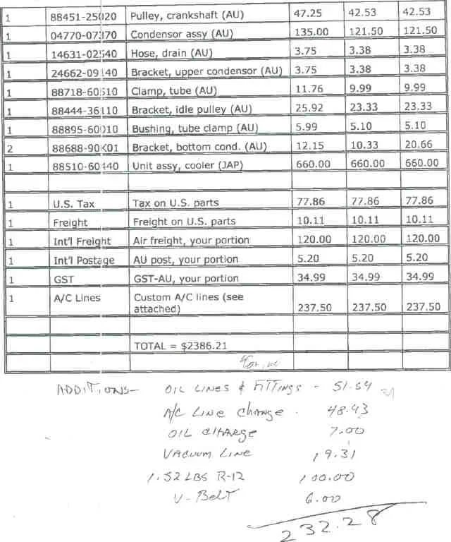

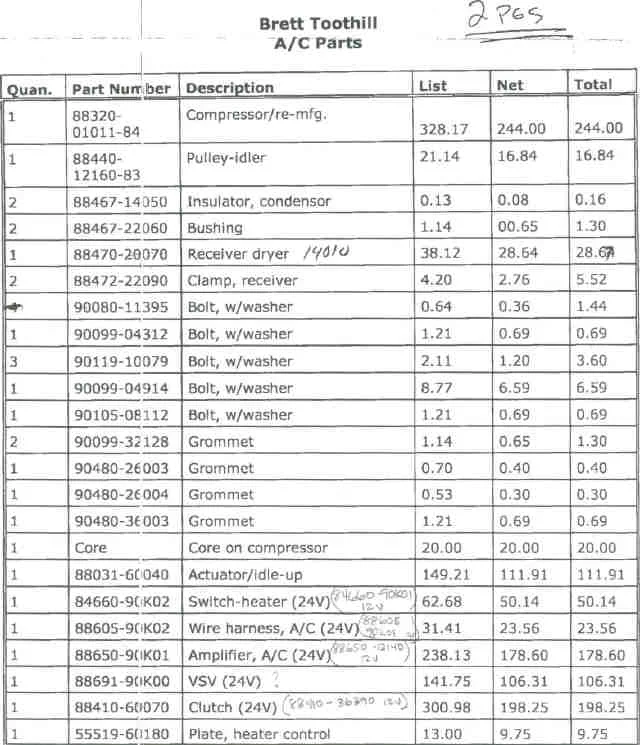

Just saw this post so I'm jumping in late. Yes, I added AC to my CDN spec 24v BJ70. Mine was done using all new, correct factory parts that were scrounged from Japan, Oz and the rest were US parts. You will for sure need a 70 series evap case. These are getting harder to find for a LHD and they are spendy little buggers. The other hard part to find is the proper 3B bracket for the compressor...for this I found one from a CDN spec BJ60 as there were a few 3B 60's that came to CDN w/ AC. The next tricky part to find is the idle up switch (24v)...according to Jeff Bryant (who found most of these parts for me), he is trying to get one of these for another guy in Hawaii and can't find one.
The rest of the stuff (Recv/Dryer, hard lines, soft lines, grommets, wiring harnesses) should still be accessable from OZ or US. For a compressor, we used a factory rebuild from a mid 80's 4-runner. Wes, if you have the parts list scanned, feel free to post.
The real expert on this is Jeff Bryant. He has done three 70 series AC jobs now and anyone who knows Jeff knows how anal he is about using factory Toyota parts....his work on conversions is second to none. My AC works perfect and you cannot tell that is was not fitted from the factory

Interesting, I did find 12v part #'s

We got the evap from dave steadman in japan...brand new. It took a while to locate one IIRC. I think it was $750 USD back when the dollar was strong.

ahhh...make that $660...it's there in the parts list
