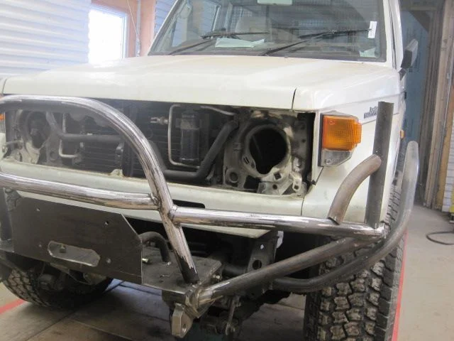

It appears like the front wheel is only held on by 3 lug nuts currently.

that is for moving around the shop, not for driving.
since the diffs are being completely stripped and PC with Elockers installed it didn't make sense to stick all them back on.
quite the attention to detail there John.

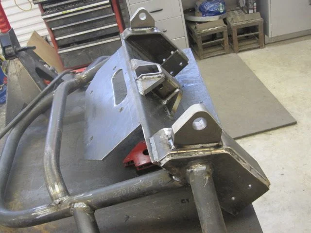

it was a year long coversation that resulted in this build even taking place.
the front bumper is complete, side bars are completed, the sliders can not be completed till the rear bumper is done.
the rear bumper is starting with the rear mount PTO being installed.
the PTO had seized bearings which are on order.
the factory tank is now up for sale since it is in the way of the PTO drive shaft.
custom middle and rear tanks are being measured up.
it is important to have front bumper protection:

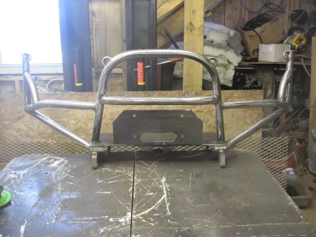

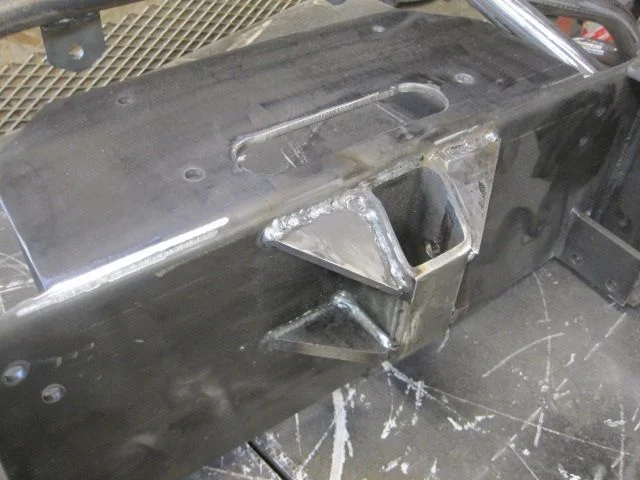

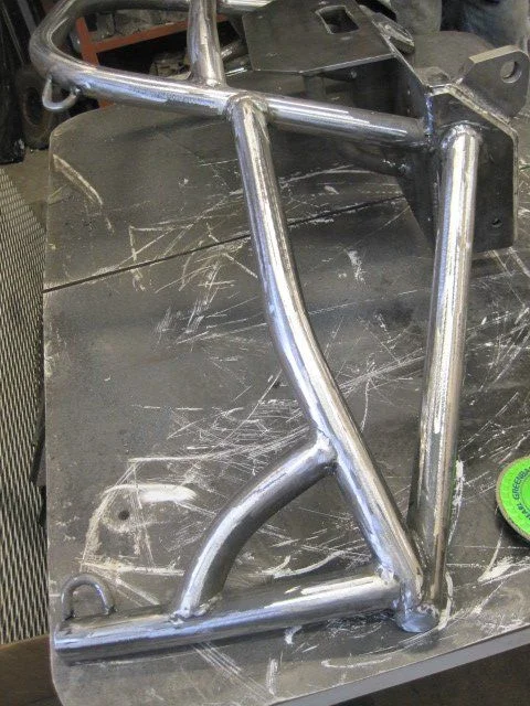

couple more bumper pics.
customer wanted uprights with cable attachment points.

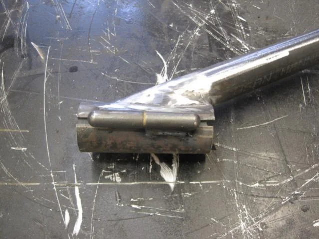

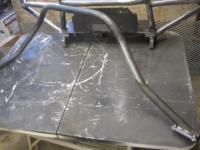

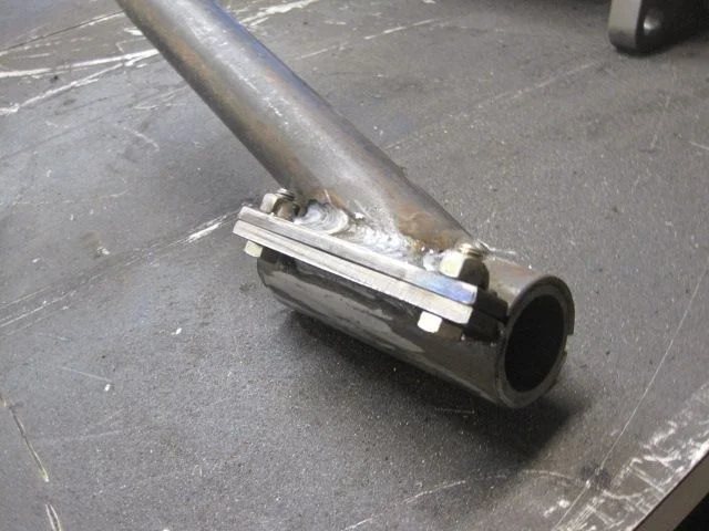

front fender side bar protection:
had to be removable and strong.
complex bends with hinged rear mount onto the sliders.
