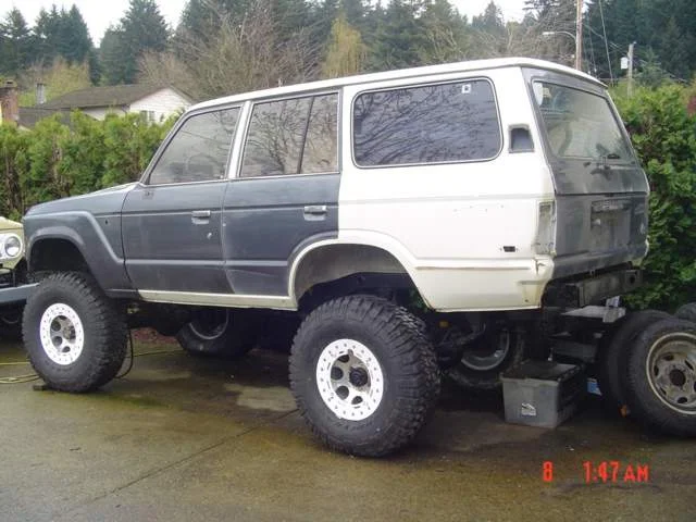

What the customer wants the customer gets..........
I think it looks pretty cool, might be a bit tippy.

may i make a suggestion?
take about 3 leaves out of the rear and 1 or 2 from the front, figure out how to hook up the front sway bar even if you have to weld the mounting tabs to the top of the axle...
make sure you have anti wrap bars hooked up front and rear or you will be snapping ujoints all the time...
use adjustable shocks front and rear so you can control the sway, stiffer in the rear...
you can tell me to bugger off i woun't be offended...
cheers

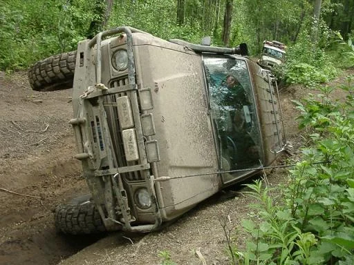

Its funny that people are saying its going to be "Tippy" It has Tippy's axles and exactly the same lift formula. Spring Over on OME's. Its a winning combo, leave Tom alone.
