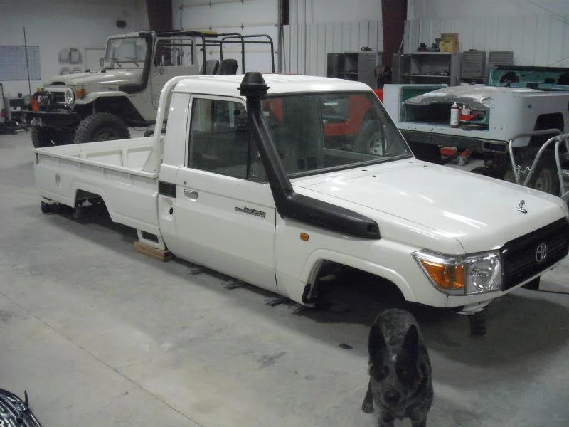

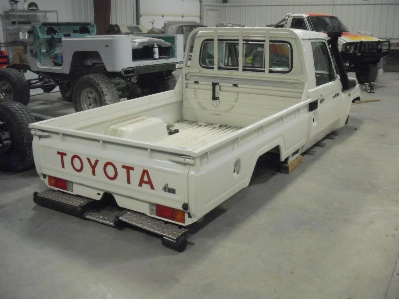

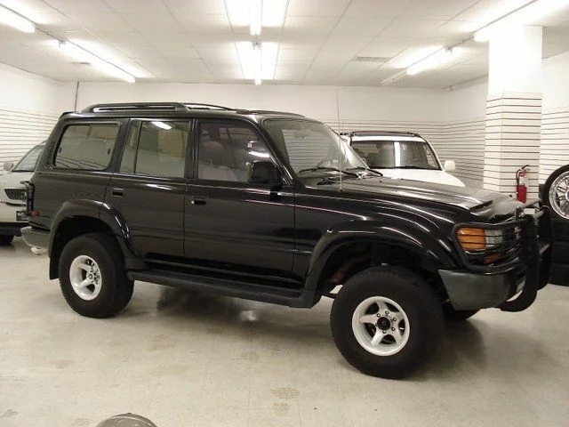

So it begins.
I purchased one of the FZJ79 pick-up bodies that Proffitt's Cruisers imported from the Middle East. The build will probably progress as funds are available. I will be mating the FJ79 truck body on a 1996 2 owner, 165,000 mile, FZJ80 frame and drive-train.
My vision is:
Remove the 80 body from the frame and lengthen the 80 frame as needed.
Re-tube drive-shafts if needed.
Hopefully retain the 80 fuel tank.
I will strip the 80 series wiring harness of all unneeded items like power windows, power door locks, power antenna, AC, under-seat heater, power seats, etc...
Use 89 Toyota Camry front seats, FJ75/80 steering column, a FJ75 dash and gauges with the 80 series harness mated to it, I hope, the 80 E-Brake mechanism,
I am sure this will be a learning process.
The first picture is the FZJ79 that will be on its way from Proffitt's.
Suggestions welcome....
