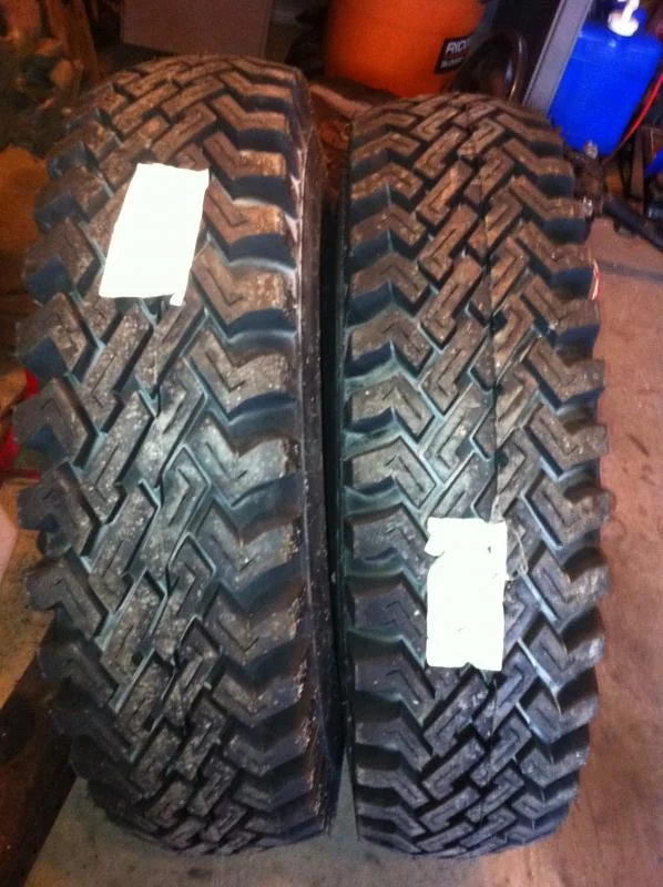

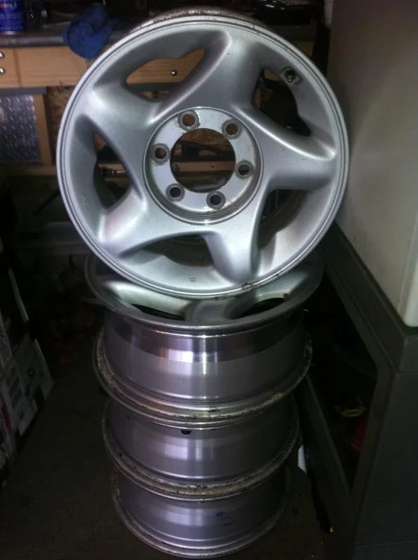

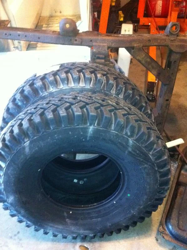

Scored some rims off Craig's List and picked up 2 STA Superlug 9.00x16 tires. The rims were $100.00 for the 4 and the tires were $193.00 a piece.
The rims are in great shape, but I am thinking of changing the color. Would love to powdercoat them, but will probably go with a spray job until I know what color looks good with the white body of the 79. I'm leaning towards a gunmetal gray. I am worried black would be too much of a contrast against the white body. Opinions welcome.

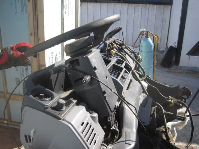

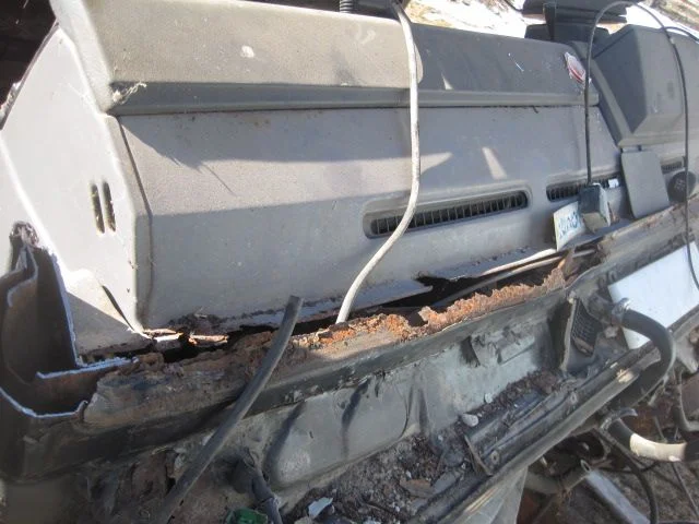

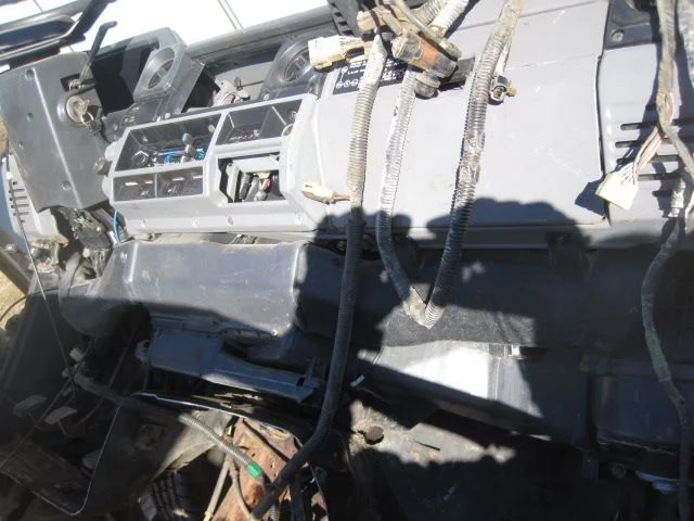

Complete dash has been sourced, thanks Crusher, now I just need to take a trip to Canada to pick it up.
Does anyone know the paint code/color of the gray main steel dash section in the 70 series cruisers? Looks like the one from Crusher will need a little bit of restoration and would like to paint it before putting it in the truck
The build can now be shifted into high gear. Need to finish stripping the 80's body off the frame.

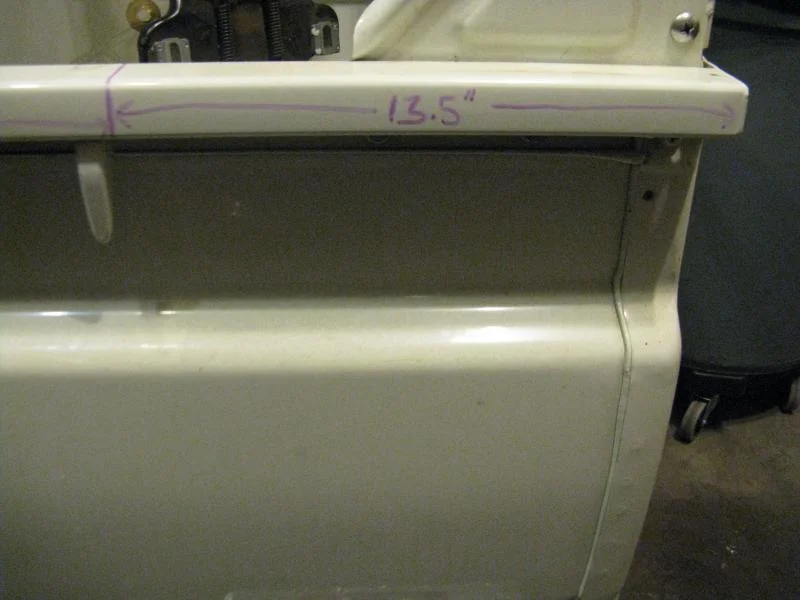

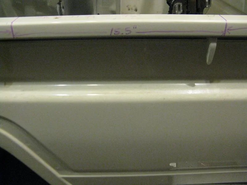

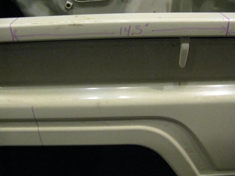

New twist on the build.... I have seen one of these builds with the front of the bed shortened to give an overall bed length of about 77.5" or 6' 5 1/2" bed length. To tell you the truth, I like the overall look of the shorter bed better than the very long bed that is stock on the 79 series.
My plan... Remove 13.5 inches from the front of the bed. This amount is based on what Swamprunner estimated that he had to stretch the frame to line the center-line of the axle up in the wheel well. With 13.5" removed from the front of the bed this would give me 15.5" from the front of the bed to the bottom leading edge of the wheel well or 30" to the center of the wheel well. This would give me an overall bed length of 77.5" or 6' 5 1/2" and what I think is a better looking truck.
The benefits of shortening the bed instead of stretching the frame would mean that I wouldn't have to lengthen/modify: the rear driveshaft, emergency brake cable, brake lines, fuel lines, exhaust, cut and welding of the frame, lengthening of the rear wiring harness, etc...
Opinions???

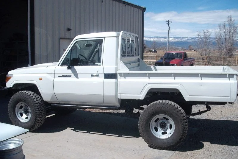

Picture of the truck that gave me this idea. Wheel base is 115". 80 series wheel base is what 112"?
3" difference. I guess it will depend where the 79 series cab falls on the 80 series frame. I really would prefer shortening the bed than the frame and everything else that goes with it. And I would be getting a better looking truck IMHO and one that would be better suited for wheeling. And fit in the garage better.

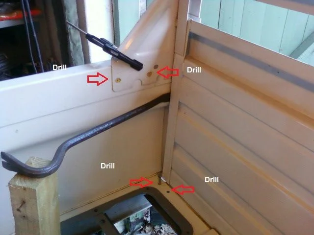

Pictures of where to start the shortening of the bed.

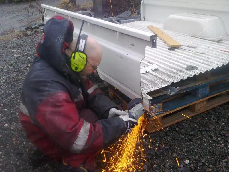

Cutting the bed doesn't look all that hard.
