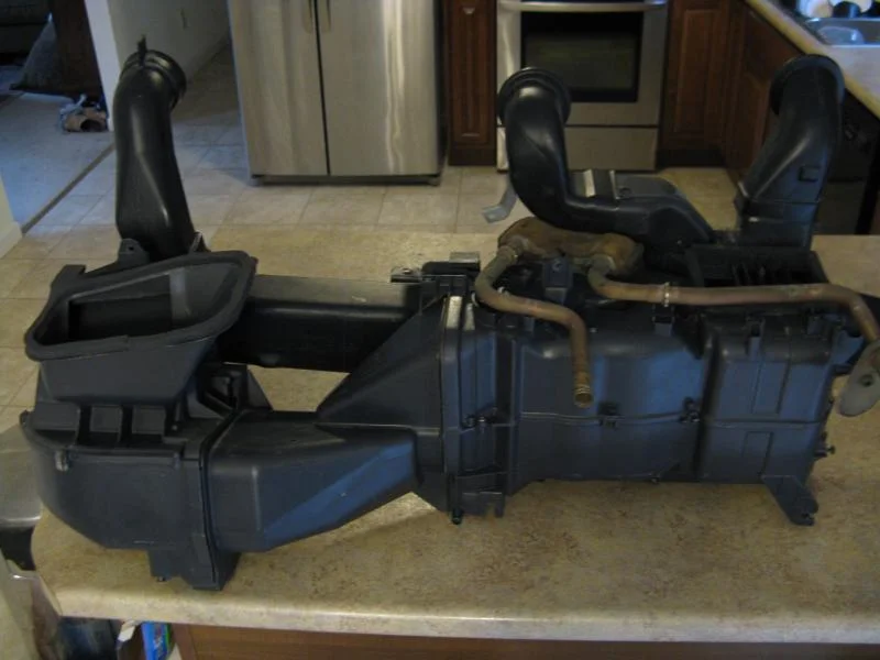

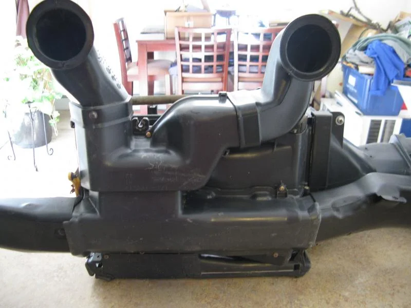

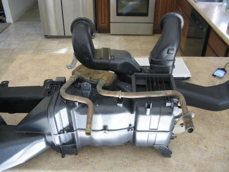

Getting ready to re-install the heater. I took everything apart and cleaned 25 plus years of dust out of the heater. I also replaced all the foam that seals everything. After 25 years the foam was pretty dried out and would flake off at the slightest touch. I did not replace the heater core as it looked to be in good shape. I gave it a good flush and hope this will be sufficient.

When I first got my HJ75 the heater was marginal at best so I flushed the heater core. I ran water through it until it ran clean ( you would not believe the crud that came out of that thing). After a couple of days I realized the heater was still not operating properly so I "flushed" again which resulted in another 10 minutes of brown water.
I ended up flushing the heater core 3 times ( the last with detergent ) before it started operating correctly. The moral here....at least in my case it took multiple flushing to guarantee the heater core was indeed free of crud.

Point well taken, I'll flush it again and see how clean the water runs out of the heater core. Is there anything other than clean water that can be used to clean it? Like CLR or some other chemical?
Good idea to clean them out. I came across a parts HJ75 once that had caught fire.The owner said he started it up with the heater on to warm the cab and went back to finish his breakfast.When he went out 10mins later the fluff in heater fan had caught fire.
I felt a bit sorry for him,he was an old guy and didnt have much .The 75 looked an easy repair to me but he had been given over the top prices to repair the electrical damage,all it really need was some new harnesses from the wrecker,but by the time I got there many parts had already gone.
