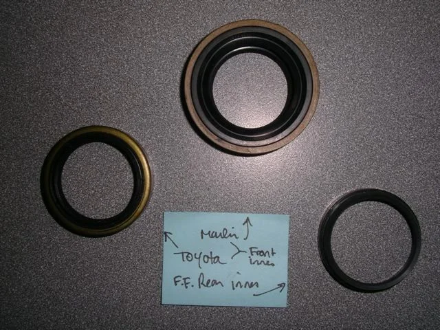

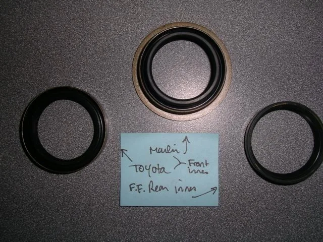

Here are some photos for you... the outside of the seal in the first pic, and the inside of the seals in the second pic.
~John

awesome thanks for that mate
