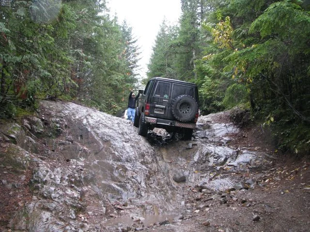

Which trail are you doing in the picture? It looks quite familiar...

Sunrise lake. The V-Rock section. I'll see if I can figure out hat I'm measuring down there. I've never rebuilt a land cruiser T-Case but I've done a few Rover ones so I should be able to pull it off.

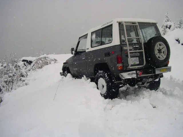

I installed the Mark's gear set into Coleman (will follow up in my build thread soon) just over week ago and it makes a world of difference in the low range. I went with 1.00:1/3.05:1 ratios.
I did a snow run on Remembrance Day to go up to an aircraft wreck where an air crew lost their lives in 1941 and the gears really helped make forward progress in the snow a lot better (where slow speeds can make all the difference).
The gear whine is noticeable, but not that bad in high range. In low range it's more pronounced. With better sound insulation, the whine would not be bad at all. I have yet to use the recommended gear lube and that is supposed to reduce gear noise quite a bit.

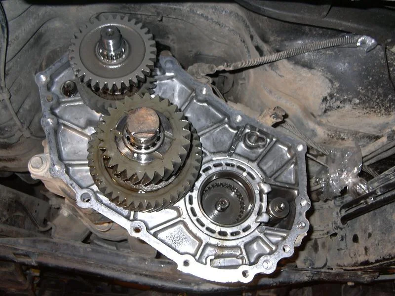

The idler shaft protrudes through the rear t-case cover and a segment is cut out for the lock tab. Easy to see (rusty end since its exposed). Measures O.D. should be 38 mm, or if you have the earlier one its 32mm. Here is a picture of mine with the back off.
If you have 3.70 diffs, I think you want to go Marks 3.05/1.08, like Aaron suggests. The 8% under drive will help compensate for larger tires and your relatively high geared diffs.
