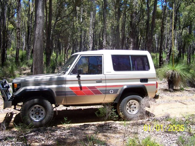

This is a pic of my 73 with a 2 1/2 in lift with 33 in BFG,they have never rubbed.
Some say my front shackles are too vertical ,but I never had a problem except needing a castor adjustment
