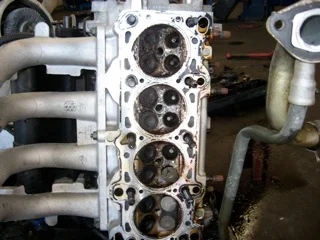

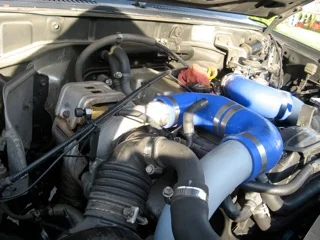

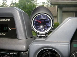

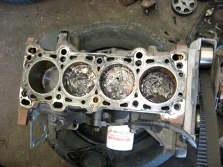

first, sad news. there is many other places to stick the money LONG before you go after cosmetic do dads.
get a pyro installed IMEDIATELY
get a larger exhaust installed to get rid of the exhaust heat
get a larger rad installed IMEDIATELY
get the EGR block off plates made and installed
increase the boost and leave the fuel alone, decrease the EGTs
you are driving a time bomb engine and failure to do the above will leave you stranded ... and not in your driveway.
i have seen the results first hand. when the head blows (and no, it will not be a head gasket) you will be looking at $4000 in repairs and another $2000 in upgrades. most ignore the advice and later post up about hte damages.
if you do not like what i say, ignore.
do a search on LJ78/2LTE/2LT and do some research. the rest of the truck is bullet proof but the engine is not.
then, if you have not blown the head in a year and you still love the truck THEN start doing the mods you want.
(hint: i just picked up a 1991 LJ78, the lady bought it against the advice, sunk $6000 into the head and turbo and then the bottom end cratered. in just over a year she had $22,000 invested. she stuck it up for $6000 and i bought it for $3000.)
they DO NOT hold their value.
and unless you drive conservatively AND do the above suggestions they you will be heading down the same road as her (and many others on Mud here).
<i can not beleive no one made these suggestions before now>

okay,
so i read this and i get the idea you are a bugger for punishment. "I HAD to have it"...
4 core recore the rad.
i am installing a PZ/R141 into a LJ78 as we speak. it is not cheap but it solves the engine issues. you can install a 3B, 13BT, 1HZ, 1PZ, HDT into the LJ and the limit is your budget.
there is no long term cure for the L series problem. what i would do, if i was you, would be to keep an eye out for an old mine truck, a BJ70, a PZJ70 or a wrecked 80 series to swap into the LJ when the engine dies. this way you are not paying top dollar for the swap parts. but IT STILL WILL NOT BE CHEAP.
do the suggestions and watch the EGTs (Exhaust gas tempertures), if you do you might get some decent time out of the engine.
my second suggestion is do NOT invest money into it for "fun" mods till after the above is completed.
but
it is your money, your truck and your time... so do as you please.
cheers and best of luck.
<i know i am coming across as an ass but i am tired of seeing so many people still buying these time bombs.>
<< for the money you are about to invest you could have bought a decent HDJ81 or a HD 70 series>>

May be yo ushould just buy my HZJ77.
turbo inyercoolered,lifted,bumper,winch,runs on used cooking oil.

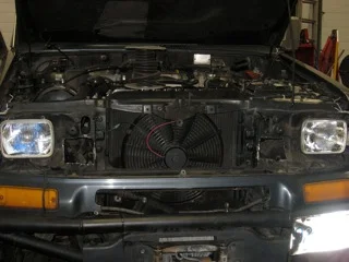

Hey Nmontairo. With 195,xxx km's your 2lte it has probably had head surgery already. The so called updated head is slightly better but still has a tendency to over heat and crack. Like Crushers said put in a ect and temp gauge. I use Prosport gauges and like them a lot. dberwin a member here put me on to the gauges and there great.
Does your A/C work?? You can also remove your condenser in front of your rad and mount a 16 inch electric fan. Put a switch in your cab that you can use on hot days, long climbs ect. I use a 82 degree thermostat instead of a 88 degree. John at Rocky Mountian Import can help you out with that. The 82 degree thermostat I feel helps the most of all and also make sure your coolant is in good shape. Another good idea is to increase your boost for the power lacking problem. I run twelve lbs of boost and it seems to like it. You can buy a boost adj valve off ebay for cheap. These are all cheap enough to try. Drive it for a while and see if you like it. I love mine.

the best way to drive the mountains is using the pyro as your guide and TAKE YOUR TIME/ if the pyro starts to climb beyond 1200F then drop a gear and slow down a bit. even a slight decrease on the throttle will make a difference to the readings. the higher rpms will purge the exhaust gasses quicker, the slower speed will keep the water temp down.
remember, water temp and exhaust temps are completely unrelated so you can be running 900F EGT and still go into the red with coolant temps. the reverse is true, you can be perfectly fine with the water temp but the EGTs can be in the 1400F.

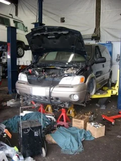

Hey Rowen. Sorry to hear about your first RHD purchase, even though nothing wrong has happened. I do agree a EGT and Coolant Temp gauge should be installed immediately. After the gagues are installed you can then learn how to dirve the truck and not let the engine heat up to much. I have been driving mine for 3 years and I'm going on my forth. I just got back from a 5400km trip with my truck and one other truck from Vancouver B.C to the Yukon and back in nine days (we were hunting and got a nice Bull Moose). I replaced my cylinder head every 1000k's and got great mileage on the way back because I lightened the load of five cylinder heads. Ha Ha Ha just kidding the truck ran great but a slow go. If you don't feel good about the trip out then don't take the truck. If you do, like Wayne said, take your time and don't get frustrated.
The only great advise I can give is please do not be afraid of your vehicle blowing up in your face every time you start it up no matter what car or truck you own. Trust me catastrophic failure can happen to any vehicle. It would suck to live in fear.
Here are a a couple of pictures of catastrophic failure.
The first is a 2002 Kia Reo with 68,000 km's. She was driving about 100km's an hour when the timing belt let go. Around $3700.00 later I installed used motor. The second was a Pontiac Transport with 131,000 kms's. The oil pick up tube fell of the oil pump while going down the Hope Princeton and bam a $4800.00 installed long block. Ball joints, cylinder heads and gaskets, transmissions, rear ends ect... can cost thousands even if you keep your vehicle in tip top shape. While selling your truck take care of it. Relax and enjoy I hope the best of luck for you .
Take care Jeff.
