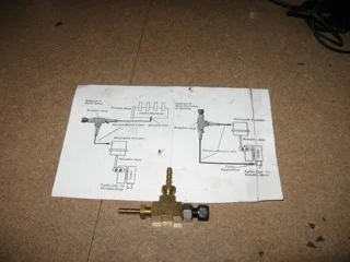

Hey Keith. I use a NXS boost controller from Ebay shown below it's cheap, simple and easy. The ECM on your 2LTE is capable of controlling the fuel ratio to about 14 lbs of boost max. If you exceed about 14 lbs of boost the ECM goes into a fail safe fuel control mode and in my truck it feels like the e brake comes on slightly and there is a power loss. When the ECM see's an over boost situation, it dosn't know if a vacuum hose failed, or the boost pressure sensor has failed ect.. so it runs the fuel system in a fail safe mode to stop engine damage. At this point the orange check engine light comes on and then goes out when the boost pressure is back within the max limit. If you run 13 lbs of boost you will see a initial spike of 14- 14.5 and then it will settle to 13 where you set it at. 13 is about the most you can get without the check engine light coming on (at least in my truck). If you buy a boost controller I recommend you use a boost gauge or fuel pressure gauge to set the boost controller to the the boost you wan't to run. If you don't have one then install the boost controller and make the check engine light come on and then back off till the light dosn't come on this will be your max boost the ECM can handle. I run around 11-12 lbs of boost. If I run a slight bit more I see no performance gains and I feel that my turbo dosn't need the extra stress for no reason. Also rember that the higher boost pressure you run the hotter the intake air charge will be that's why an intercooler is a great idea.
Good luck.

Sorry I forgot to add that I'am playing with an idea to put in a bleed off valve inline with the vacuum hose to the boost pressure sensor. The idea is to bleed off a pound or two of boost so the ECM thinks I'am running 11/12 pounds of boost but in reality I'am running 13/14 pounds of boost I don't know if anyone has tried this but less fuel + more boost should = cooler 2LTE. When I get around to this I will let you know. Hope I don't open a can of worms!!
Take care
