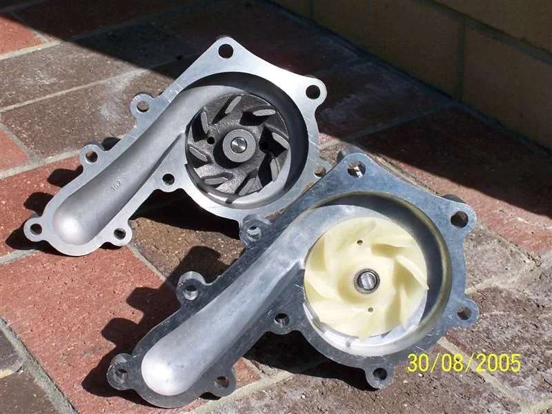

l have seen a few 1HZ came with plastic impeller on the waterpump,if the engine got hot on the 1HZ,the plastic impeller may spin loose on the shaft and cause overheating underload.l have seen two,replacement waterpump usually have steel impeller.
Simon
The plastic impeller is the OEM type and mine lasted 250000 before the gasket give up.The plastic is not like shopping bag plastic
The plastic blades are longer and thinner and I suspect they may be more efficient and pump more coolant then the aftermarket type.
IMO, the OEM is worth the extra $30
The one with metal blades is a Croc brand and is supposed to last ok.
