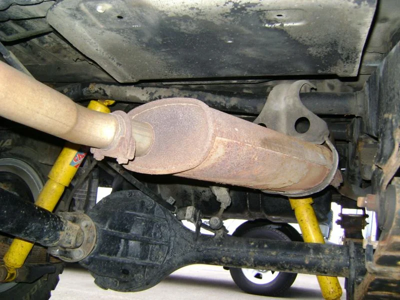

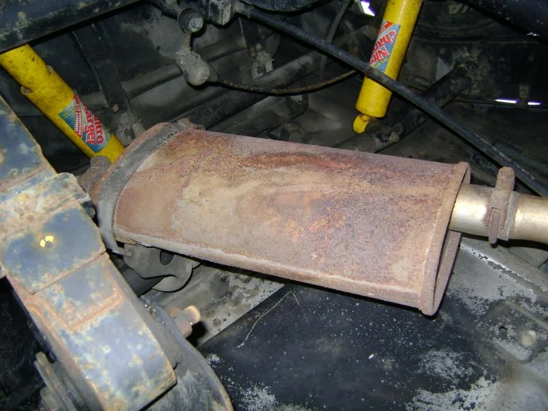

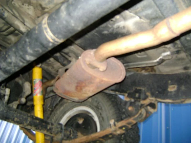

these pics are from my BJ73... yeah its a rusty muffler but it still works fine! Dimensions are 4.25" tall x 8' wide x 16" long... hope this helps... sorry but I didnt measure pipe inlet size, let me know if you need it...

Natty, thanks a lot for those pics and dimensions!
