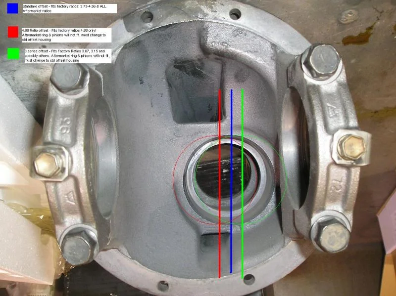

Hey Sloid. Look under your hood at the metal decal plate on the fire wall and look under Trans/Axle and see if it is a G144. The G144 is the axle code for 4.88 gear ratio. If your truck came with the G144 gears the cost to re gear it to 5.29 gears (which is the next set up) will be very high. In my opinion re gearing would be the way to go. Ringpinon.biz should be able to fill you in on the details, if not PM me.

If you have FACTORY 4.88, the offset is different in the 3rd member housing, so you will need to change the 3rd member housings. Attached is an image showing the difference. Its really no big deal, but you'll have a few hundred $ extra cost for the housings if you have factory 4.88.
