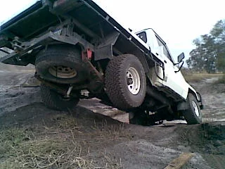

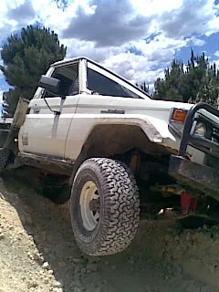

Hey guys in new here i have a 1HZ straight 6 turbo landcruiser i try to get out in it a bit heres a pic.
Now im looking at getting some lager shackles for my leaf springs (that's why i circled that one) but i don't really know what will fit?
I found these please comment if they will work or if you have any suggestions.

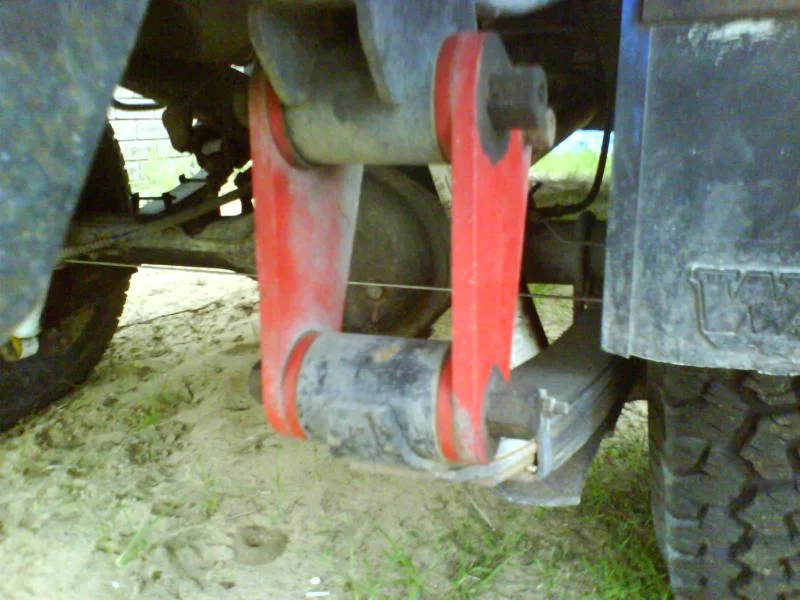

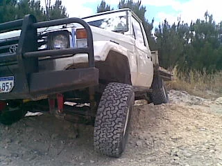

yes but only half of the shackles length is extra
but id def to it to any leaf sprung cruiser i have
I have a good quality close up on other computer i can post up tom or something if you need mate

close up

It depends if how much you want to lift it. Generally it goes up half of what the shackle size is over what you have now. 2" long 1" lift and pay the extra and get grease able pins. The other thing is there illegal in Australia. The only thing i noticed it chops out the brushes faster in the front.
