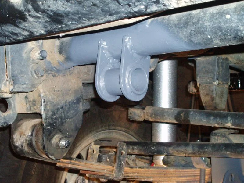

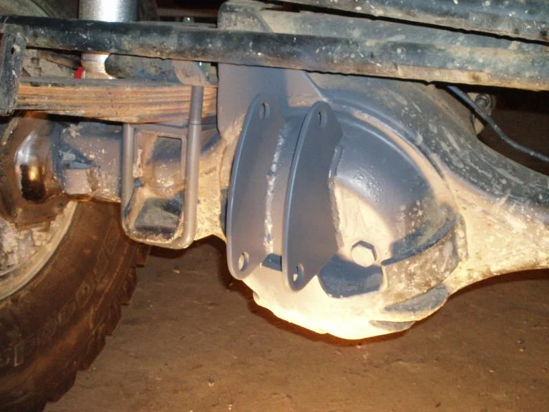

I have them fitted front and rear of my FJ73 and its the same idea you need two fixed points on the diff and one on a cross member with a shackle attached. On mine i have the bar right between the pumkin and the spring mount its a snug fit. Bottem mounts level with the bottom of the housing and the top about the top of the pumpkin they the shackle mount it attaced to the cross member behind the transfer thats the only place i had space for it and it works great i used rod ends on all the ends too. Try to keep the top bar level. Will post some pics when i take some.

You can see them both in this photo and get some idea's the lenght works well on the bak one to protect the tail shaft too. I found this photo will try to get some better close up one's soon.

Here is some more of the front one same idea. You should need one on the front unless you silly like i did and get over 600 mm of wheel travel. Resulting in about 250 mm of slip needed in the tail shaft thats why is rhs. I just use pipe that fits standard shackle rubbers in it to keep it simple.
