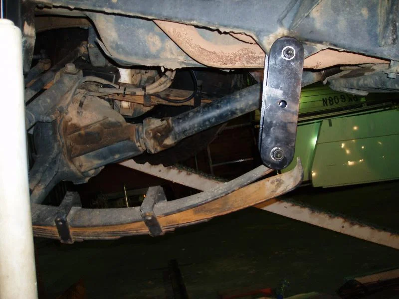

I have posted it before but not with the new 39.5" rubber. And show some leaf spring critics what the old school setups can achieve with some tweaking. the ramp is 1400 mm high and its at the top.

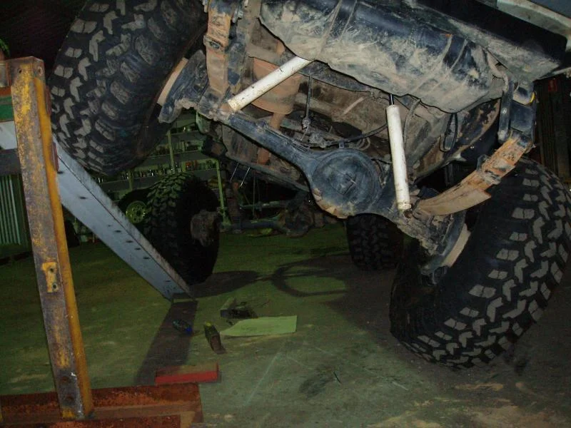

If your referring to me no revolver shackle's here. Yes shackle reversal and longer springs front and rear with longer shackle's.

HANCOCK that is an awesome setup. exactly whats springs are you running just out of interest?

Thanks Gib009 Im running 75 series rear springs in the rear and my old rear springs up front.

good setup, thats what i'm soon to run I reckon, just need to weld in some new hangers fro my 75 rears. Already have RUF, staying SPUA though.

nice flex , shocks front???

Waiting on the longest shocks I can buy 917 mm open 536 mm closed eye to eye so that they are not restricting the travel. Should have them refitted end of next week need to move both the shock hoops and bottom mount aswell unfortunately.

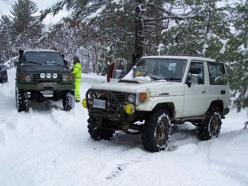

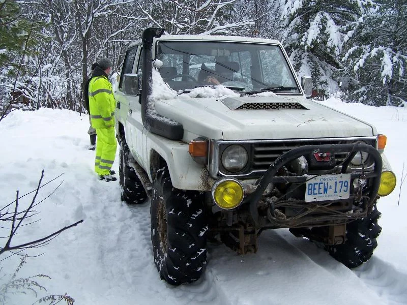

updated pics of the Tractor...
run last weekend..

Nice pic of your "tractor"
